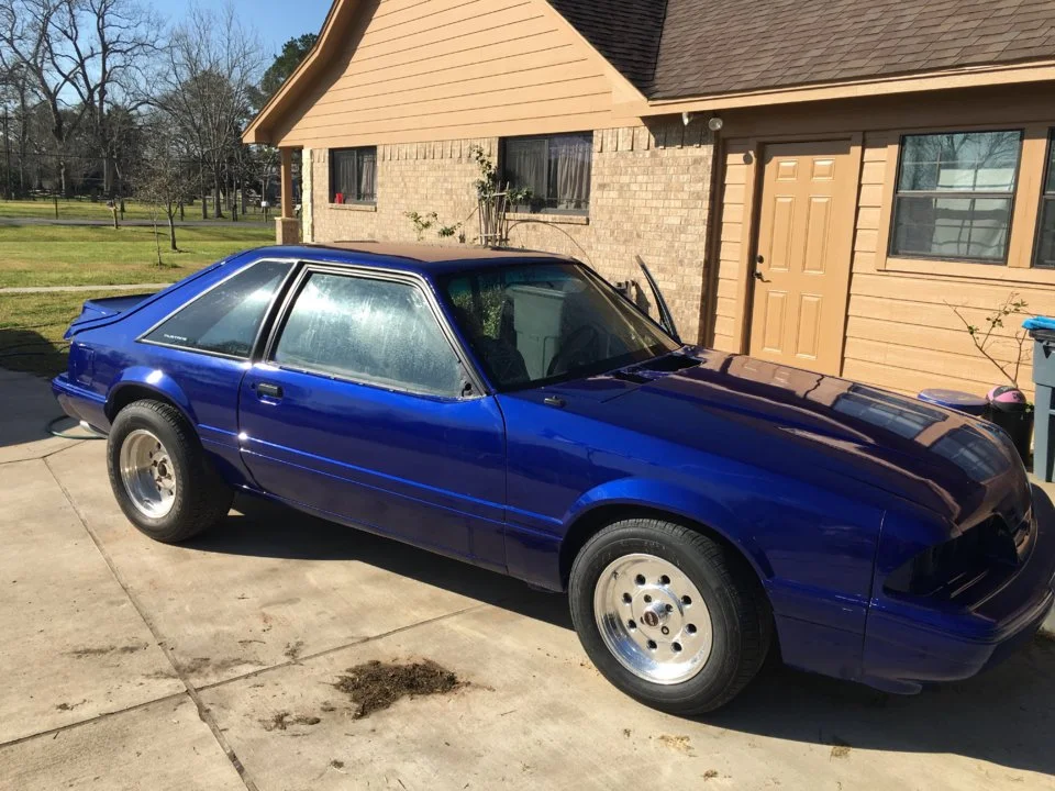

Well, like I stated earlier, you get her out in the sunlight, it quickly becomes a 10 foot car. My eyesight ain't what it used to be, and i missed a ton doing the bodywork. Hey, did you see the car before? Compound that with fighting water problems, then pressure problems trying to stuff extra water traps in the line.. Lol I KNOW I can do better next time.. Here it is in the sun
The good news is, next time will be soon, because I'm going to have to re-do the roof. Ugh. I had a problem with my filler and one batch had clumps that didn't mix with catalyst, leaving raw wet spots that bubbled up under the primer. I thought i cut out all of them and patched well enough, but more are showing up as little bubbles under the paint. It absolutely kills me.. But my boy doesn't care. He's just ready to drive. So, what I decided is we are going to let it go for now, and wait to see what else show up before trying to fix it. I have plenty of paint left, after all. My father in law tells me we are always our own worst critic.. Right now I think i might be. Now, i have to figure out how to remove swirls without a fine buffing pad...
You can hide them with wax. Don't put any on for about a month though. You have to let the solvents finish coming out of the paint.
When you wax it, use a natural wax like carnuba. Any commercial wax won't play nice with a new paint job.
Otherwise, it really shouldn't cost too much to get a grey foam glazing pad from 3m, that plus their grey glaze compound will remove those swirls.
Too bad you don't live close by, I'd take care of it for you. Well....At least show you how and give you the stuff you'd need.
The car is beautiful btw Mr. Critic. That color is fantastic!
I still think it looks great...big difference from what you started with. Of course he wants to drive it already. That car looks bad ass. Good work!
Fwiw, I would also wait a bit to see if anything else shows up before redoing anything.

Thanks fellas. I just pride myself on craftsmanship, and cringe at the idea of someone thinking it looks bad. My wife says, "Honey, it's a 16 year old's car. Not your car. Put it together and let him go hit a mailbox. Lol...

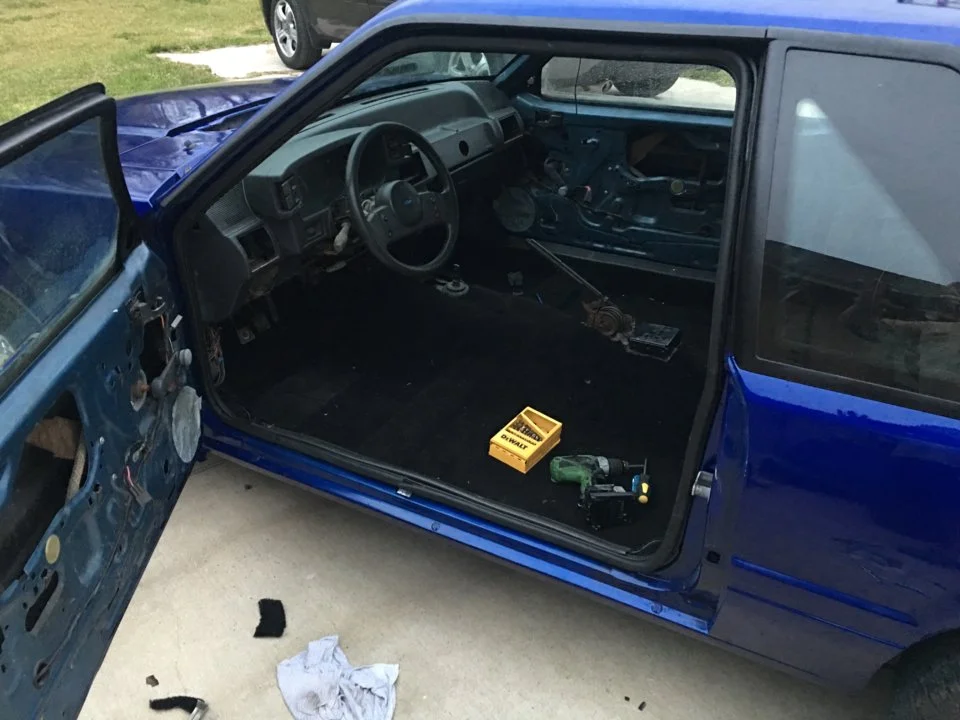

Boosted92LX said:
Man, you have carpeting! I can't wait to get to that stage.
Your boy is lucky to have that car. Outstanding Allen.
Only if he keeps his grades up.. Hehe! Then dad will have an extra car for work!
Not really, but boy does he get torqued when i tell him that.
Thanks Dave.
