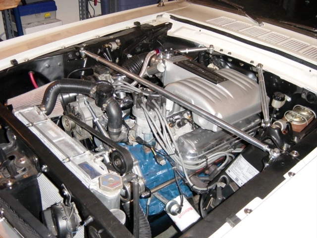

I kind of like the way mine looks in the skin of a 65 fastback....
