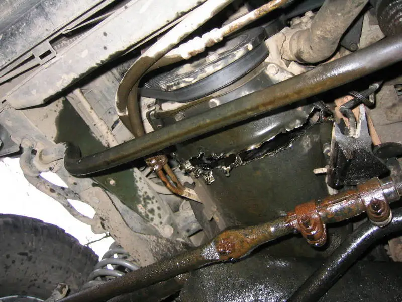

Had lots of fun with this thing until, I got a lil too crazy and took some water down the throttle body. Water doesn't like to compress.

I also can't even tell you what the hell you broke, but whatever it is, it looks bad. Did you hydro-lock?
Looks like one of the rods came down through the oil pan.
Dagger got it. #1 connecting rod broke and took out the oil pan.
The basic story is I went through some deep water and stalled the truck out. Did the cap, rotor and plugs the next day got it barely running. Replaced the IAT sensor and TPS, she ran like a charm. Changed the oil and the trans fuild. However the top end now had a tick and I could hear a lil rod knock.
Fast forward to a week later at Midnight, I'm driving home on the hwy from the girl friend's place when 'BANG' she lets go.
I had planned to fix it but to do that the way I want would cost more then just buying a YJ and starting over. So I decided to part her out.
