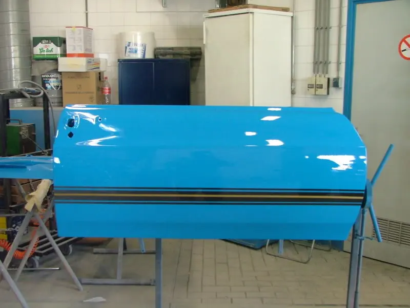

The shop is running a few weeks behind schedule. The doors are completed. As usual, the parts from NPD were crap. The mach 1 decals were cracked and the shop thought they were very, very old, which is odd because I just bought them this past July. Anyways, I was wrong about the pearl undercoat. That was what they were going to do when I first chose to go with Torreador Red. This is just blue over blue over the epoxy primer. they put the decals on and then clear-coated over them. Very nice!
This is the driver's side door.
And this is the finished passenger's side door
and this is the driver's side quarter panel extension

very nice.... i wasnt trying to attack you, or the shop doing the work, like i said earlier, just curious. when the owner of a car wants something like that done at my shop, i usually try to steer them away from it, or talk them into putting the pearl into the last coat of color, or in the first coat of clear. once again, beautiful car
New doors. The old ones were too rusted internally to be salvaged. The quality of these re-pops just suck. It took a ton of work to get them to fit, which they now do. Now, they fit perfectly. This came at great expense.
It looks like it was worth it in the end!:nice:
