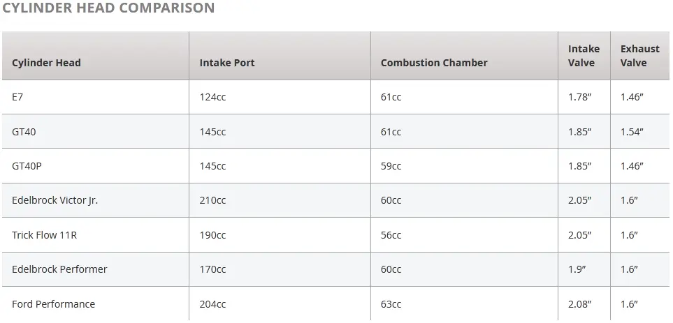

Hi guys,
I finally decided to buy a new pair of aluminium cylinder heads. I saw in your recommendations heads for 800 or maybe 600 usd. If I buy the olds 351 cast irons with 50 years plus the porting work, the difference with this new heads maybe will be around 200 usd??
I found a really good article comparing the E7, GT40, GT40p with the new ones. Somebody knows where to get the specifications intake port, combustion chamber, intake valve and exhaust valve for the 289, 302 and 351? I think will be a whole comparation.
Now the question is how much intake port it is neccesary for a 347? From 170? 180?
https://www.cjponyparts.com/resources/gt-40-cylinder-head

Port size isn't really the only determining factor with heads, although it does play a big role. In my comparisons, I found that the ProMaxx head flowed better than the Edelbrock Performer RPM with the same valve size and a larger advertised port size.
Edelbrock heads advertise 190cc intake ports whereas the ProMaxx heads advertise 180cc intake ports.
Edelbrock numbers posted on Jeg's website:
Valve LiftIntakeExhaust
.100''7057
.200''128104
.300''183142
.400''219163
.500''251170
.600''255174
.700''246175
Flow Numbers as tested by Edelbrock's SuperFlo SF-1020 flow bench @ 28'' H2O
ProMaxx numbers from their website:
Flow Data @ 28″ water
lift100200300400500550600
Int70136192233257267267
Ext66118152176190195199
So, on paper, the ProMaxx are better flowing heads, especially on the exhaust side where small Fords really need the help.
Remember, when selecting a camshaft you'll want to be mindful of your flow numbers as explained in this video:
View: https://youtu.be/JPAeepqrY-0
I hope all of this helps!
