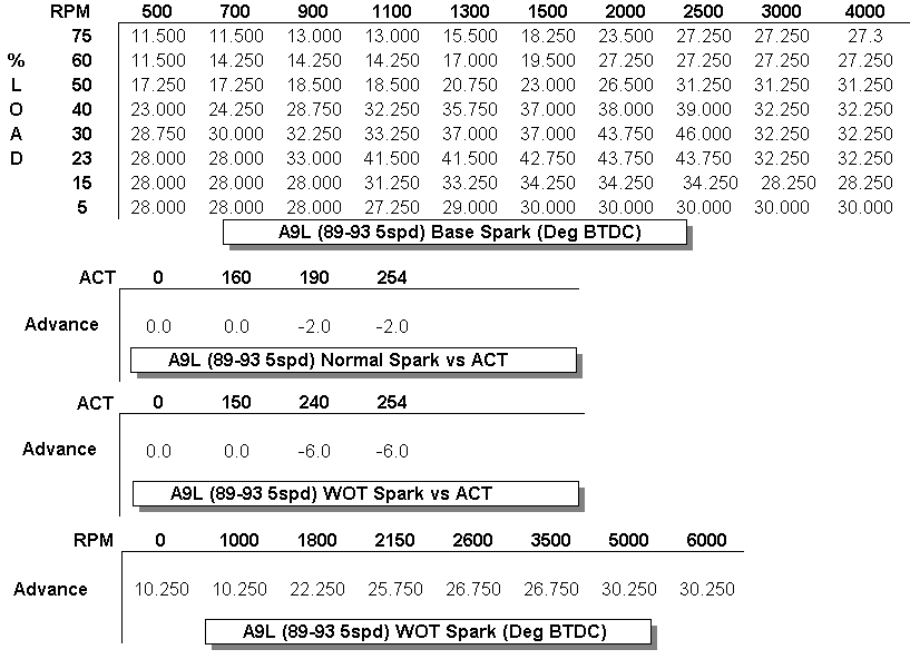

The information I am about to post is from the website www.veryuseful.com look in the a9l ecu area.
This is the table.
now this is the timing curve information for an A9L ecu used in manual transmission cars. Your ecu may have a different timing strategy than this one.
