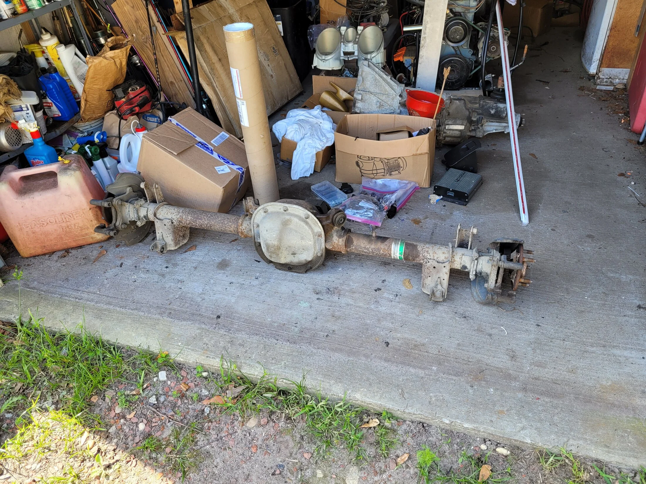

gotcha and yeah, after posting this yesterday I stumbled onto the sve ones on lmr...had no clue they were repopping them. I guess I will just move forward with it and deal with the anti moan brackets later. just do it all at once. I grabbed a rearend from a 2003 gt on thursday from the u-pull. might as well just do everything all at once.
swapping to this vs the stock rearend in my 95 gt vert. 2.73 to 3.27 gears, 3/4" wider on each side to push my wheels out just that extra bit to fill the wells out better. going to put the cobra clutch packs in it and a girdle and then convert it to the cobra brakes before jamming it up under the car with a flowmaster catback I snatched from the u-pull a couple months ago. just do it all at once. oof.
