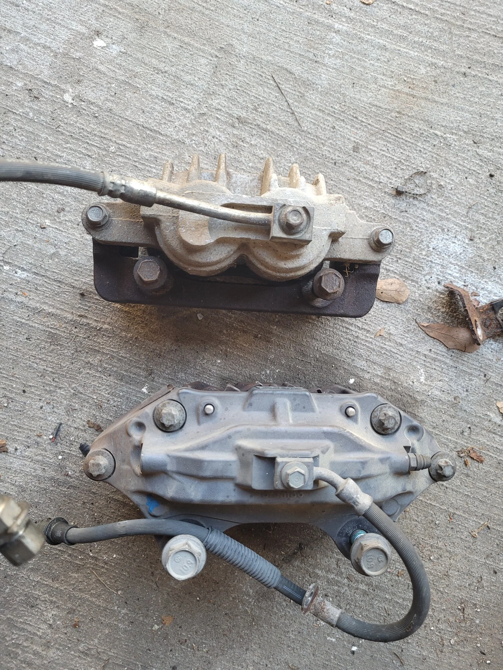

so, I've been reading on the ATS cadillac swap some but have a question.
I have a 95 GT w/abs and stock brake system. I have 95 taurus SHO rear calipers and 99-04 pbr front calipers all ready to go on my car. I grabbed the soft lines with the pbr calipers as well when I was at the u-pull.
then I stumbled on the youtube video of the guy doing the ATS conversion....and then doing the XTS conversion lol.
was back out at the u-pull and there was an ATS there but it only had the driver side caliper left. I grabbed it and its soft line for $20. I have found a passenger side caliper online for $50 but it does not have the soft line with it.
I looked at the caliper mounting point on the pbr caliper and the ats caliper and they both look extremely similar. do I need to find a passenger ats soft line or has anyone used the stock 99-04 gt softlines on the ats calipers??

You won't use the ATS brake soft lines. You need to use the mustang specific lines just for mounting and conforming the required bend. I used aftermarket lines which had a rounded head, not sure if the OE 99-04 lines will bolt up.
GM and Ford used a bolt spacing for their calipers that was 1-2mm off. Not sure if this was done on purpose by one of the manufacturers, but it's close but not perfect. You can hog out your spindles, or buy the recommended caliper inserts.

I used the same soft lines with my XTS calipers as I had on the my previous Lincoln LS calipers (very similar to PBRs). Basically the banjo bolt thread is the same for the Cadillac and the mustang.

hmm, did you use 94-98 or 99-04? I have both but right now I just tried putting the 99-04 line on the ats caliper and it wouldnt bottom out. its weird. I hold the banjo bolts next to each other and they seem to be the same length...I will try using the ats banjo bolt on the mustang line later when I get a chance. I also had to put the mustang line on backwards as compared to how it hooked to the pbr caliper so thats another weirdo thing...
Ford made a course and fine pitch banjo bolt for the SN95 calipers depending on the year. I have both and neither fit my ATS brembos.
Edit: Early Ford banjos are M10 x 1.0 and later ones are M10 x 1.5. I think the transition year is around 2001/2002.
Oh that's not what I meant. It actually threaded in fine. It just didn't seat properly is all. There was still a tiny bit of play on the attachment point.

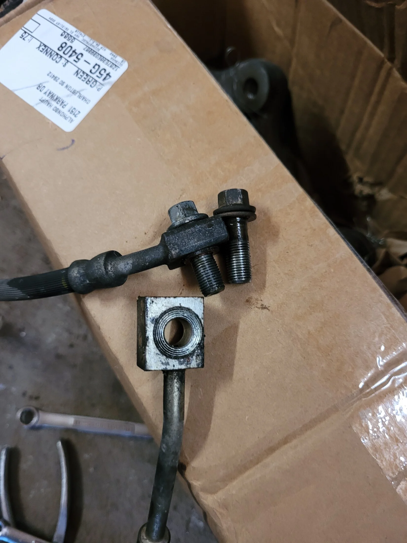

Got back home and sure enough,the inside crush washer was stuck to the mustang caliper. Snugs up perfect now and with the mustang banjo bolt. Here's a pic if the Cadillac and mustang banjos next to each other.

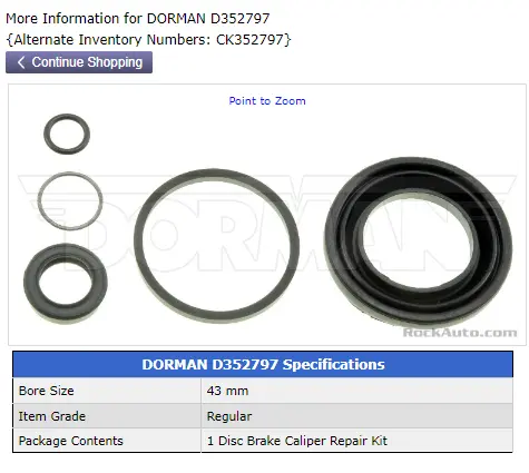

hmmm, trying to order the 43mm rear caliper rebuild kits and not sure what ones to get? the calipers I have are from a 95 sho as all the regular taurus's in the u-pull had drums on the rear. went on rock auto to get the rebuild kits and it is saying the rear bore is 54mm? Dorman D352797. there's also a FVP Fh41148 and rasybestos wk2797. anyone know if any of these are correct? I assume bore diameter is for the caliper body and not the piston bore itself...
ahhh I didnt even think to look at the info. when you look at it in the drop down menu from the vehicle selection it had 54mm for whatever reason. again, I think that was for the bore of the caliper housing vs the piston bore. just ordered.
