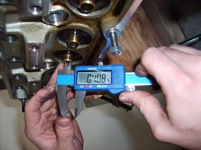

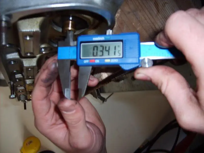

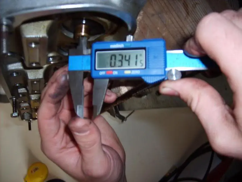

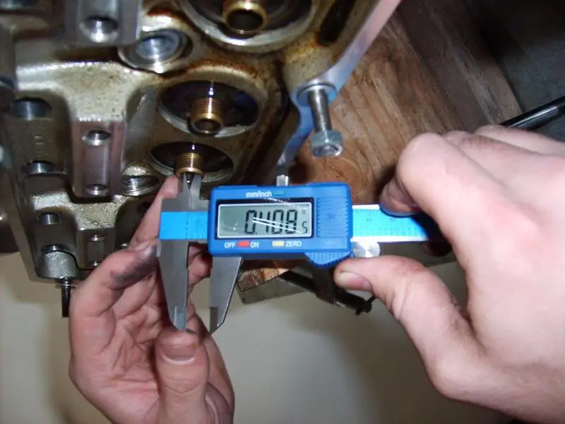

I own a pair of Afr 165s and I have had them for about 1 year with 10,000 miles on them with I thought to be no problems. I tore my engine apart today and found that 3 of my valve seals were broken and I thought that mybe to much cam or somthing on my behalf. Well I tore the head off and took the spring off and and in the process of pulling the valve out I noticed that there was a lot of play in the vlave giude. After doing some measuring I found out that my head as the inccorect valve guides in it but only on three of the cylinders and the fourth one has the correct one in it. One of them is 0.067 play in it. There should only be about 0.03. I have not checked the other head yet as Afr told me not to take it apart. My car still ran and it ran a 12.7 like this. Really wierd but it ran so beware. Will keep up updated on what AFR does for me. Sorry so long
View attachment 346965 ms/q215/stooges701/SD531840.jpg[/IMG]
Correct ones
Oversized Wrong ones

I think there is an easy way to tell if it was AFR's fault. Put the valve back in, move it around. If it is the wrong valve guide, you should be able to move the valve head and tip both the same way. If you can't, the guide is worn due to some other circumstance and the valve will "rock" in the guide. Basically, the guide doesn't wear evenly, so there is more material in the middle of the guide. I have a hard time believing AFR put the wrong guides in only 3 random valves, and since you have put miles on them, you shouldn't start blaming them until you know for sure.

Yes I know for a fact that I have the right valve train and correct pushrod lengths. If it was worn guides I would see scratches in the cylinder walls, bearings and or find metal in the pan which I found none of these. I also found that they measure up to the same size guides as a bb chevy. I had a shop here in my town look at them as well. He says that usually that if the were to wear that much you see it on the valve stem and the guide will be egg shaped not perfectly round like mine are. He agrees and says the wrong ones were out in the head. It was not just 3 valve guides it was 6 valve guides{3 sets} in one head that was incorrect. The guides are the same size from top to bottom telling me that there not wore they are incorrect.
The AFR Guides should measure around .343 for their 11/32" valve stem size. They are NOT the same size as a Big Block Chevy. The BBC has a 3/8" stem size making the guide on the BBC around .373 as their valves usually measure .371. Looks like the wrong pushrods were used and the geometry is all screwed up.
I agree there may have been a mistake made here on AFRs part and not a geometry issue, looking forward to what you find out. If it were a geometry issue that was SOO bad it wore a valve guide from .341 to .408 there would have been other obvious signs/failures besides the fact that its only on SOME holes.
