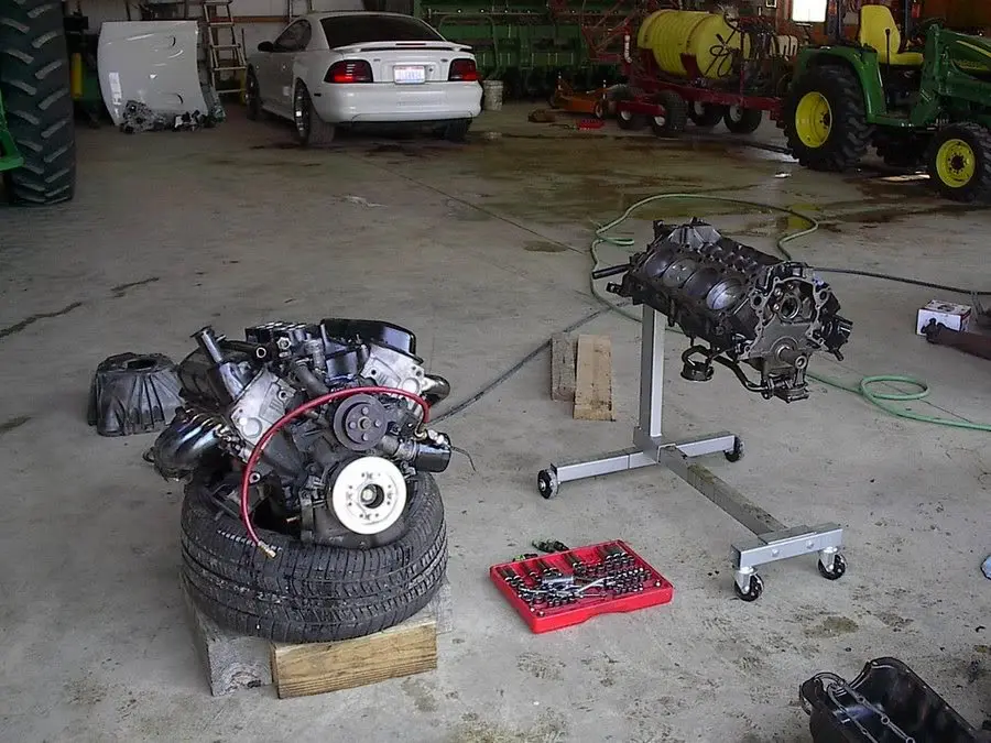

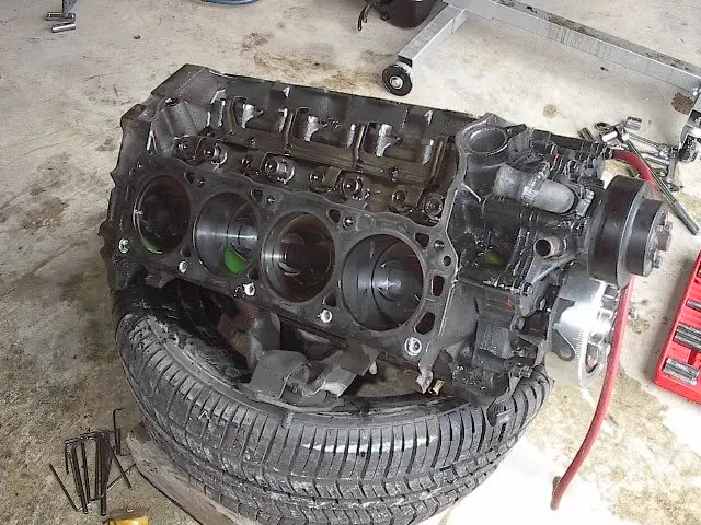

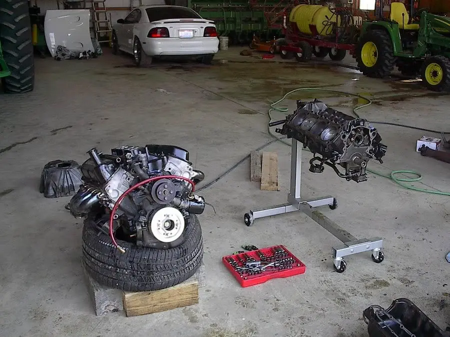

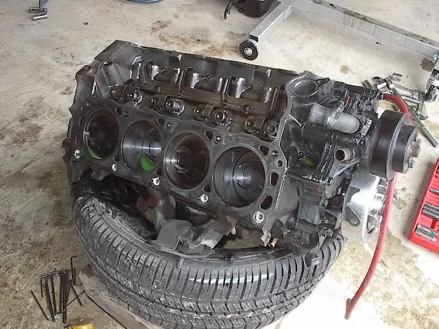

eh i really dont have a picture of the side angle.... but this was the best i could do... this particular balancer was a little smaller than stock so i had no problems
