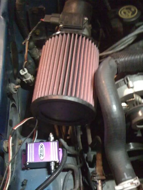

He's talking about the management unit box. With a BBK CAI mine fit where the airbox used to be. Other than that, you have very few options due to line length

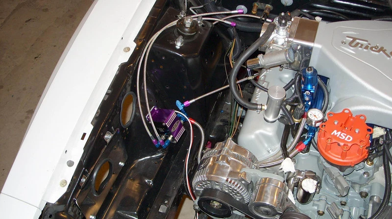

take off the wipers then take off the cowl vent put the box close to the passaenger side there is a ton of room for it and no one will know its there. Drill a hole almost even to the intake tube and run the line right into it, cover it with some split tubbing and your done, not really but close to it
Grommet on the pass. Side behind the glove box. Its for the harness to go through but there's room for a nitrous line. That's how I always did mine
