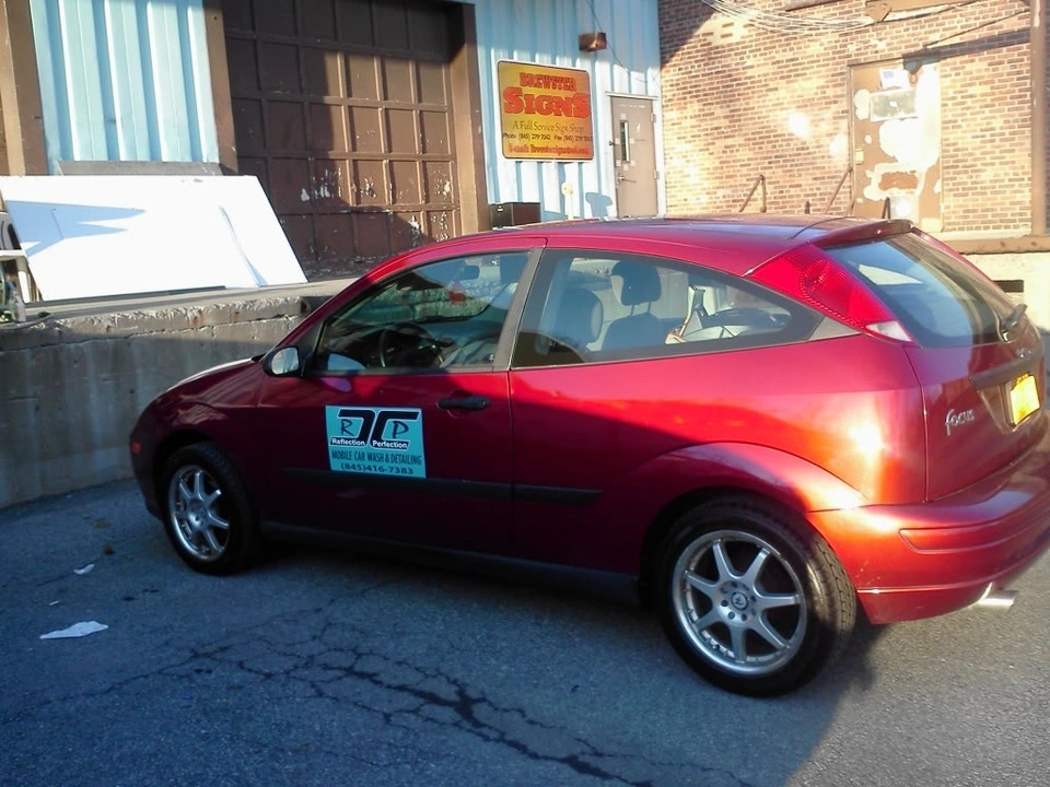

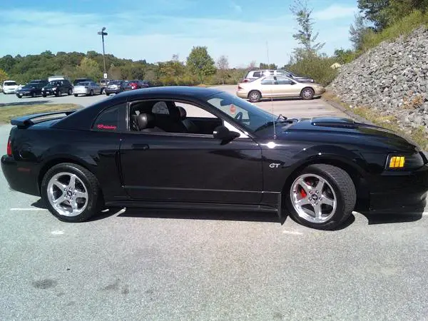

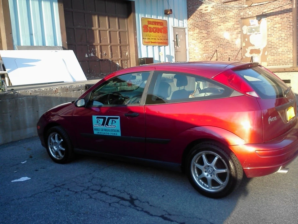

I have been running my own Mobile auto detailing business for 9 years now. I learned a lot along the way. Here at StangNet I noticed we have a few members that currently practice the detailing trade. Any questions regarding paint care/correction, interior care, leather upkeep.... ask away.
I sold my s-10 last summer so I a currently use the Stang and Focus for my business. My clients love the mustang and always ask so many questions about her :).
