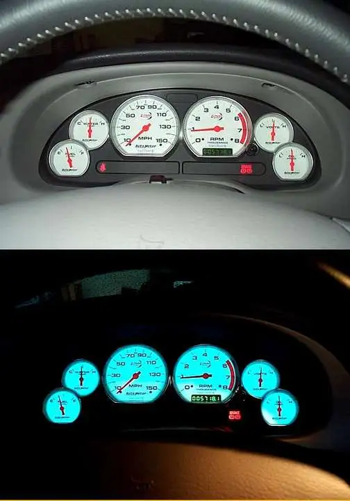

I have it, and think it is greattttttt!

What do you do with the factory gauges when you do this? Do you have to stuff the cluster somewhere or is it safe to unhook it? I wouldn't mind having a full custom gauge set but I like my odometer display...

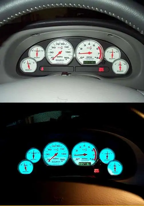

While we're posting gauges, heres mine
you unplug them from the two harnesses that connect to them. you then tap into the wires on those two harnesses to get the signals for the autometer gauges. the speedo has an odometer but its naturally on zero whenever you get it.
