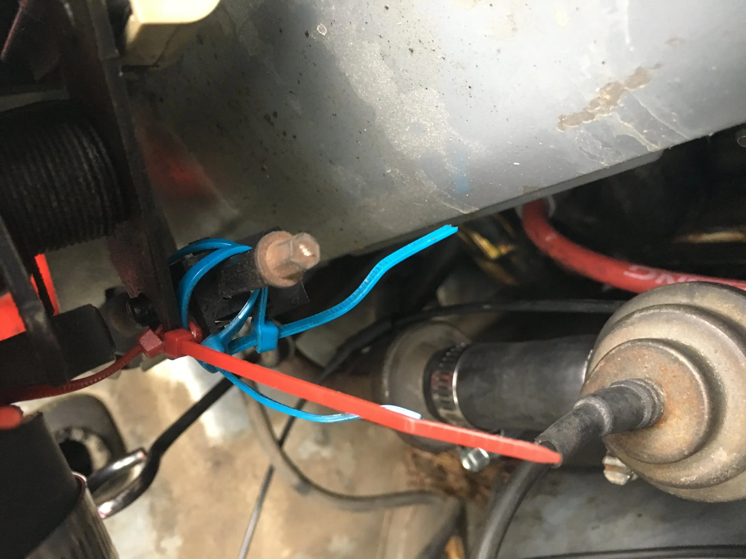

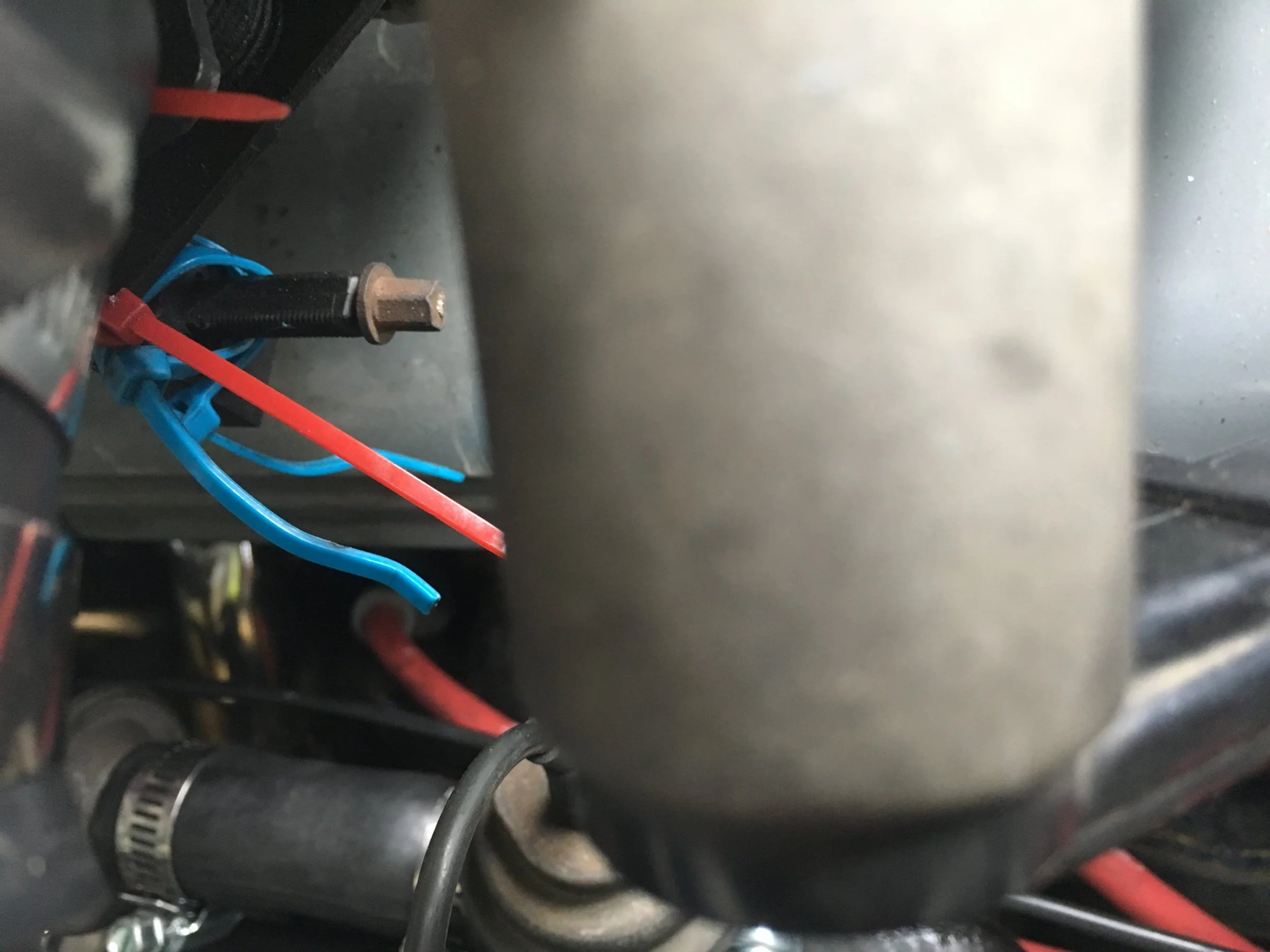

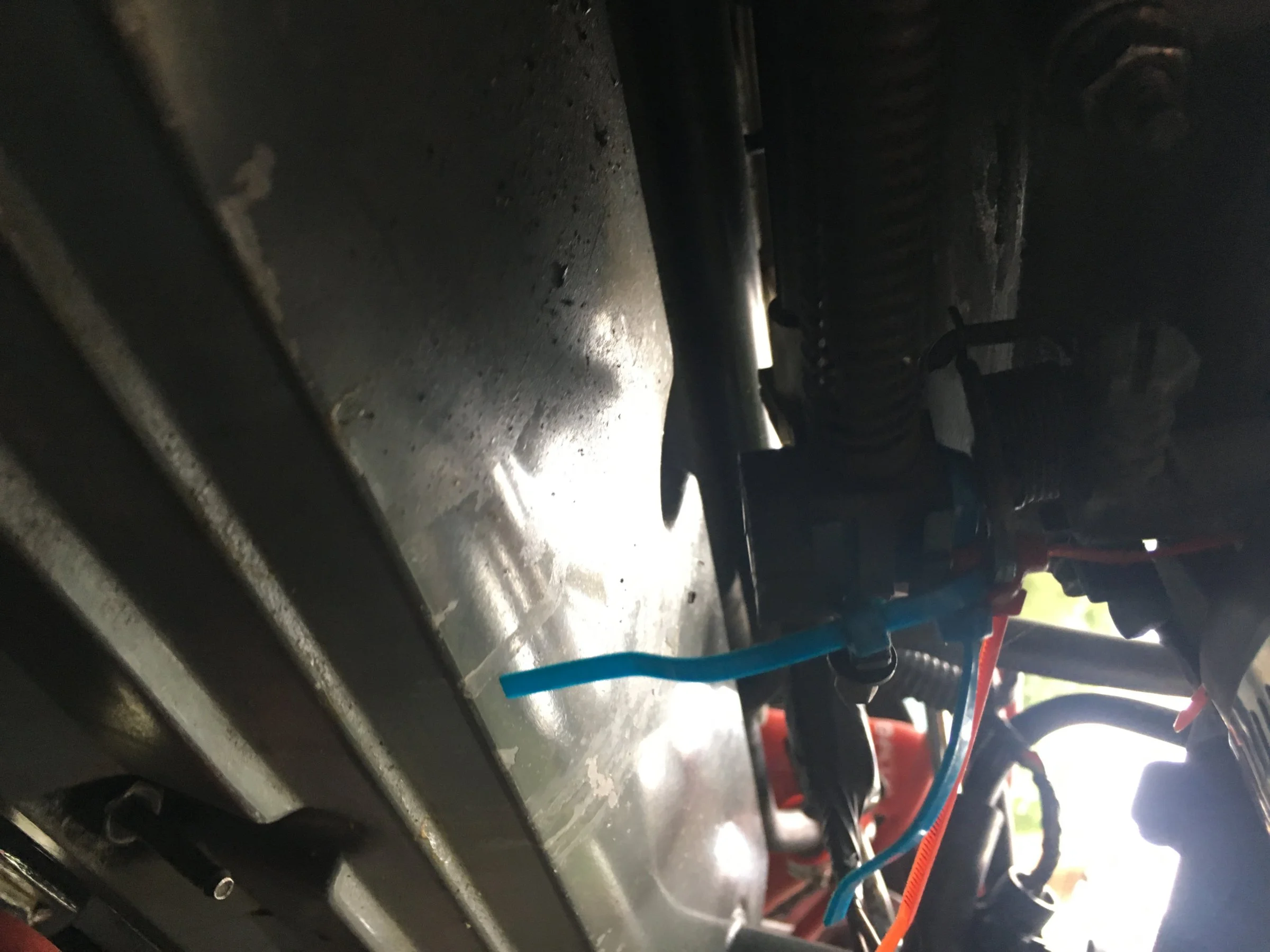

There are zipties on that cable attached to the throttle body for some reason

Pictures?
Sounds like the rods broken

it should like like this

87stang92sho
Active User
May 7, 2017
52
Jul 4, 2017
  • Jul 4, 2017

mikestang63 said:
Ya some mechanic shop did this

get the proper brass bushing and cotter pin and have the TV cable properly set per the line pressure
what's the name of the nutswinger shop that did that hack job repair
