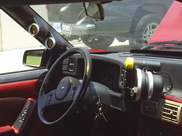

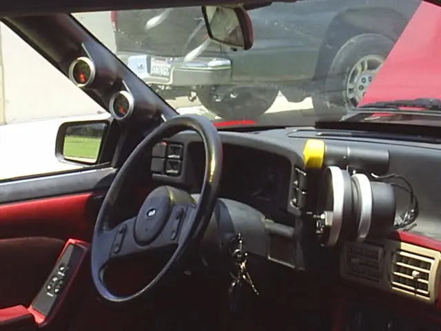

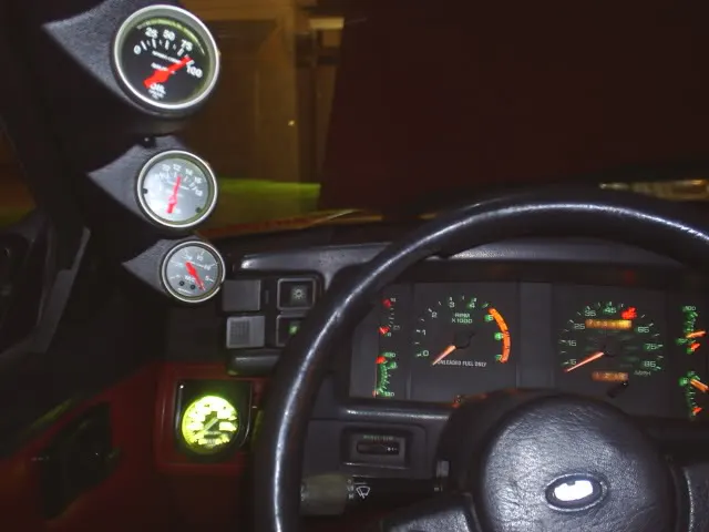

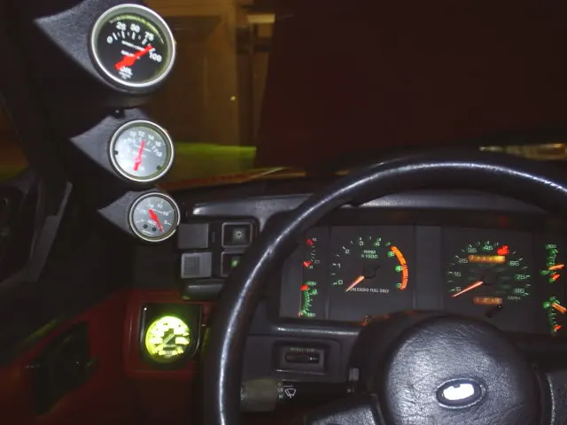

I have the Phantom Gauges (Elec. Air/Fuel Ratio, Elec Fuel Pressure, Mech Boost/Vac). The Fuel and Boost Gauges are illuminated, and you can choose them to light up RED or GREEN. Mine are mounted on my Drivers A-Pillar versus the vent...I like my A/C blowing right in my face! But, its up to you. The Ultra Lites, I believe are more expensive, not sure. But, I do like the look of the Phantoms! :nice:
BTW...I purchased the Ford Racing A-Pillar Mount and the only difference was it says "Ford Racing" on in and its visible through the windshield...it was like $30 bucks more! :notnice: O yeah, in the instructions it had Autometers address at the bottom! Go figure! :bs:
i bought two ultra-lites and a pillar pod 2 weeks ago. they do come with lighting and bulb covers. on mine the ring lights up green at night.
Did you all go with 2 1/16 gauges or 2 5/8? Just curious because the vent mount is for 2 5/8. I figured this was the easiest install so I would go with the vent mount. How does the a-pillar pod mount? Do you have to drill holes or anything? Or does it just slip on over the existing a-pillar plastic deal?
I just finished this install a few weeks ago. I got the ultra lite oil pressure and water temp. Mine light up white (like a regular bulb). Looks good at night. I got the 2 5/8 and mounted them in the center vent. Oh and yes they are electrical.
