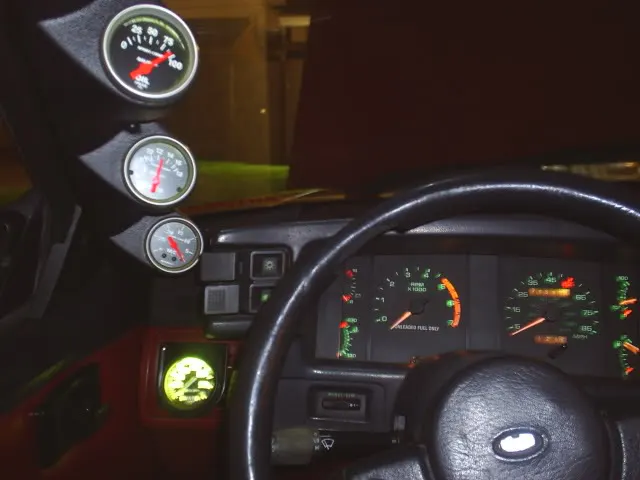

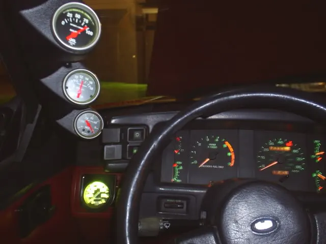

Pretty happy with mine: 2 1/16" Ultralites in the pillar and Sport Comp Silver liquid filled on the dash. I used the Autometer pods, and bought everything from Summit. Didn't have any instal/fitment issues. Never did a vent cage, but I'm interested in how you like it since it's the only place left for me to put them when the Turbos go on. Here's how it looks though:

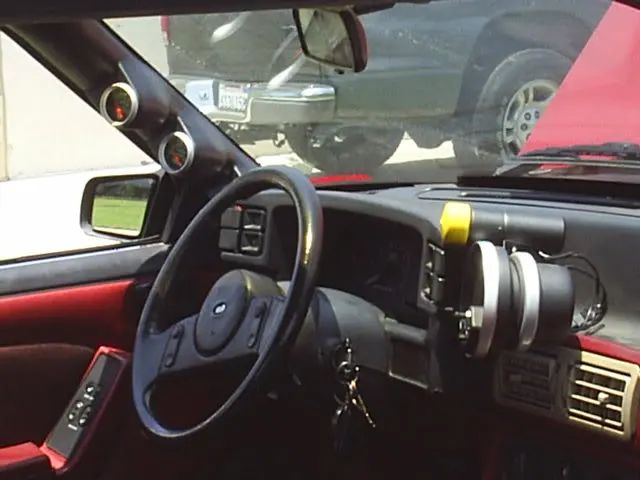

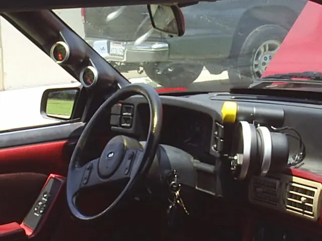

bmorrisj said:
i love my setup, i just have sportcomp gauges, elec. oil and volt meter, and a mech vac and water gauge
Where did you get those black guages?
