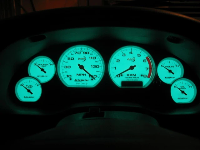

Installing my new Autometer lunar cluster. Everything is cool except the speedometer is pegged at 150 and won't budge. All the other gauges seem to be working correctly. Has anybody else run into this?

Pics of speedo malfunction:

I will send it back I was just trying to avoid pulling it apart and reinstalling my stock one. Kilgore, I tried the diagnostics mode and it sweeps down to about 90 and back to 150 and sits. I'll try the battery trick. When I'm driving and get to about 45mph it starts to move back to 90. Using the digital speedo right now, in diagnostics mode.
