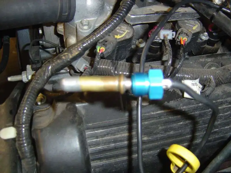

First is a picture of the sending unit. From what I've read on Stangnet and depending on who to listen to, this will either bottom out when installed in this spot or will be a perfect fit.
attachment.php
So, before I get into this again, will this sending unit fit properly into the specified location? Will it fit using just the blue connector? It seems like it won't because the tapered part of the sending unit won't have anything to snug up against in the water jacket.

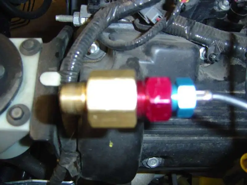

The gauge also came with the red 5/8 inch adapter. When it's threaded on to the blue part, the sending unit is nice and snug. But, 5/8 is too big to fit into the block. I do have a 5/8 inch to 3/8 inch reducer but when all are connected the tip of the sending unit does not extend past the end of the final fitting. This doesn't seem like it should matter to me. But who knows anymore. Here's what all three look like together:
attachment.php

The Autometer mechanical water temp sending unit DOES bottom out in the aforementioned hole if you try to just use the blue collar. Not even close. In addition, the shoulder does not tighten up properly.
The red 5/8 inch adapter provided with the gauge does NOT fit the block hole. This hole is indeed 3/ inch NPT.
The 5/8 inch to 3/8 inch reducer I showed does fit the block hole just fine. However, when installed like this the temperature gauge never gets above about 170 degrees on a hot engine. I attribute this to the fact the tip of the sending unit does not extent past the end of the adapter. It is recessed by about 1/2 inch. Plus, this set of adapters puts the wire too close to the exhaust manifold for comfort.
