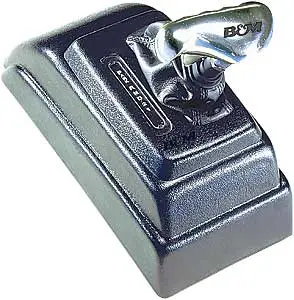

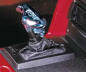

I own an '89 GT with an AOD. I plan on keeping the AOD, but swapping it out for a Lentech AOD with Edge converter. My parents asked for ideas for me for Christmas and I thought of getting the B&M Hammer shifter since it was in their Christmas price range. I'm going to run up to their house later and I know she will ask again what I want...so what are your thoughts on the B&M Hammer shifter? They say it fits the factory console...here is a pic:

From Park, Lift the trigger and pull down into Reverse. From there, its just repeated pulls until you get to the gear of choice. The shifter always recenters itself.
From 1st, push up once to D, push up again to OD, push up again to N. Lift trigger and push up to R and push up to P.
I though about that shifter for awhile until, a buddy got one. To me they are a pain in the a$$ to use. With the lentech you should be able to use a Hurst 1/4 or the B&M Pro stick. Since you have have 1-2-3 shift pattern, with OD on a switch.

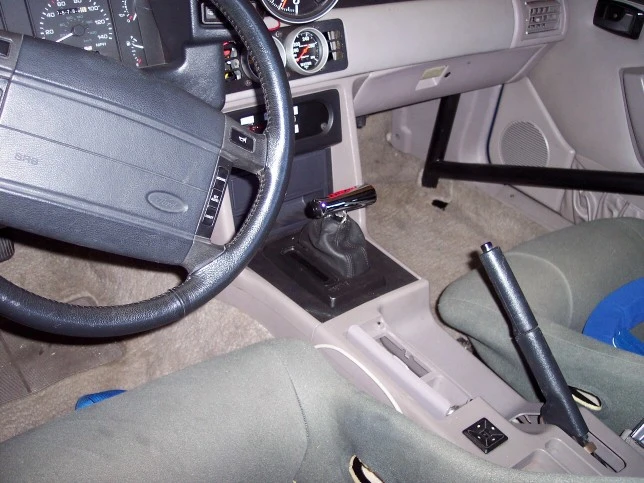

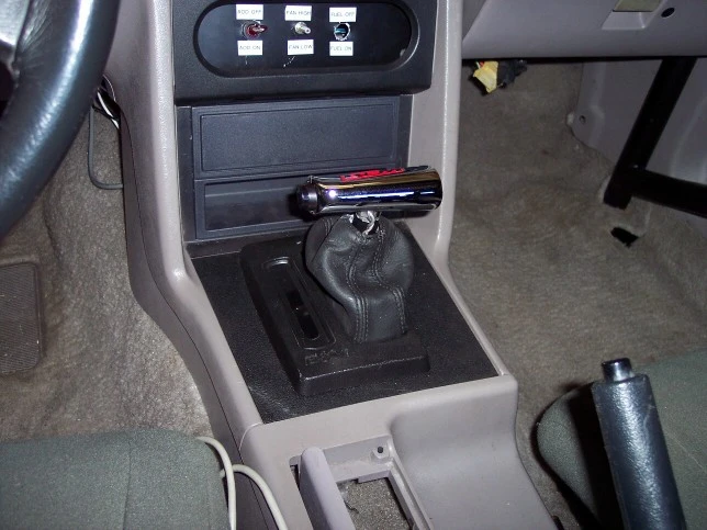

I just installed the hammer in my car and couldn't be happier with it. I also bought their t-handle with button and wired the transbrake/2 step to it. Since I run a lentech valve body, I click from 1 - 2 -3 and then o/d is controlled electronically via a togle switch. Here's a couple of pics:

What is a transbrake? Do you like the Lentech tranny? I plan on installing one later in 2006. Do you have any pictures of your OD toggle switch? Your Hammer shifter looks great too. Thanks.
