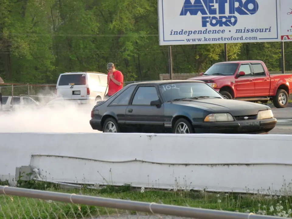

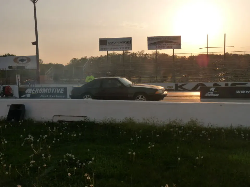

At 2:15 Wed, I got the 88 running again. A little after 6pm, I was making my first passes. The main change is more compression... I went from 8.2:1 to 10:1 compression, and the E85 is happy so far. I was also running less boost, but ran a little quicker(20psi now, vs 23psi before). I had a ton of fun out there.
The first pass, I didn't put enough heat in the nittos and spun through ALL of first gear. That netted me a 12.7@109mph with a not 'bad for spinning' 2.0 60'. Next pass, I put more heat in the tires and launched a bit softer, going 12.5@108mph with a 1.8 60'. I was only running 18psi then. After that, I cranked it up to 20psi (still 3-4psi less than last year) and slapped down a set 12.2s at 109mph with 1.7 60' times. One race was against a sweet little small block coupe that was running deep 12s, so tried to nail the tree. I guess I scared him, because he went 13.5 against me. lol Last pass, I spun a little on launch and had to pedal it, giving a 2.0 60', resulting in a 12.9@105mph. Seems the bottle is empty... :(
