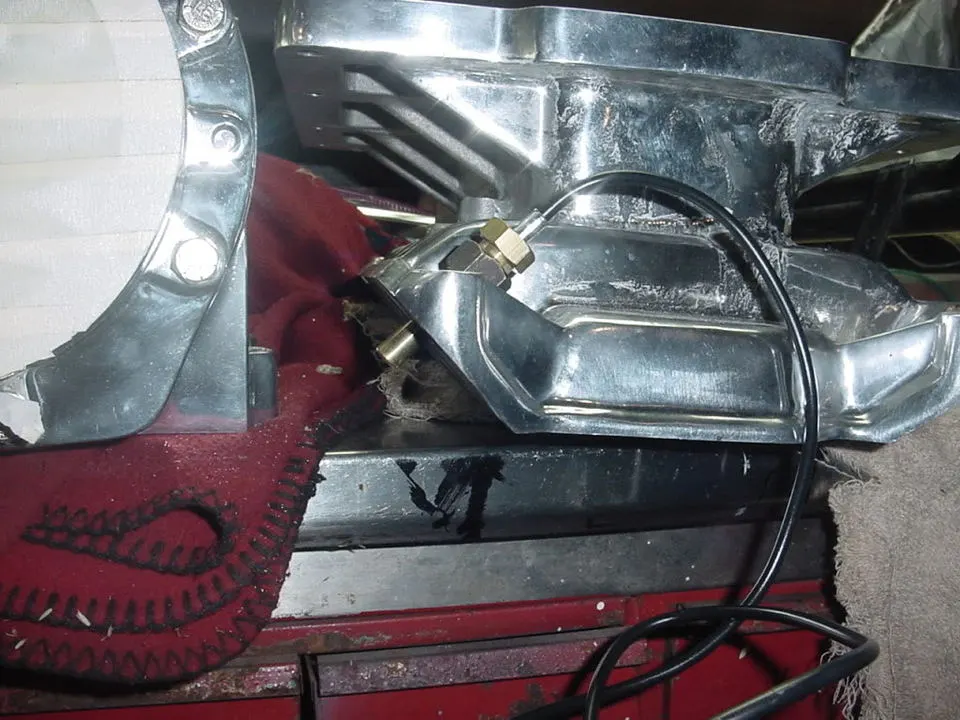

I have heard that the back of the intake will show a lower temperature than the front. So I tried it to see. Bad idea
Seems that the fluid for the cooling of the engine is only about 1/2 way through the engine and hasn't picked up the heat yet.
I switched the sending unit back and forth just to see
Hissin50 you were right and I was wrong (hate when that happens)
:hail2:
190 in the front = 175 in the rear on a steady highway cruise

I had drilled and taped two holes in the rear of the intake.
As it turned out I used both of them one for the stock gauge just so i didn't have a dead gauge and with the set up I have now I needed to use the other one for the heater. I hope that I pick up enough heat to keep it warm this fall. But i dont plan on running it in the winter.
