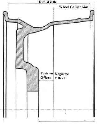

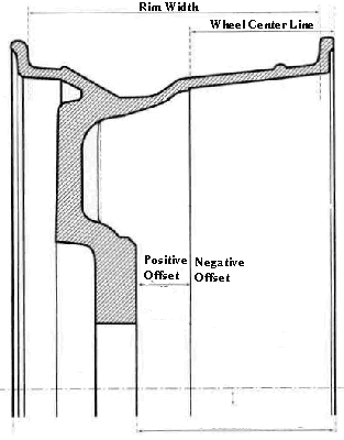

No a 0mm offset on a 8" wide wheel will give you 4.5" backspacing. I know it seems like a bunch of BS, but read this. http://www.rsracing.com/tech-wheel.html
The basics are this, rim width is measured from with in the rim lips, and center line is measured on the out side of the lip to the center. Wheel center line from Wheel backspace give you the offset.

THat is a good piece of information there. Classic forums needs a wheel/tire sticky with a bunch of information.
Thanks Shaggy! That explains the difference. It's all in the lips ;)
