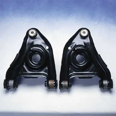

i want to replace my ball joints on my 89 mustang.
i see that summit has Ford Front Control arms.they come with ball joints
Does anybody know how easy is it to install the a arms?
thanks
It really doesn't seem necessary to replace the entire a-arm just because the balljoints are bad. Why not just replace the balljoints? It's waaay easier to replace to balljoints rather than replacing the a arm.
