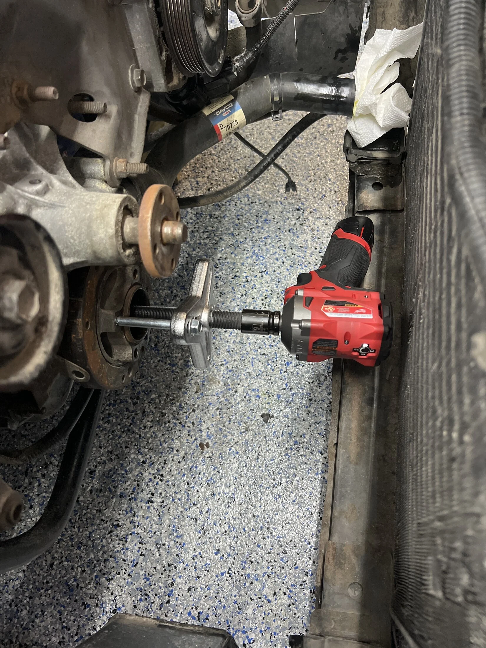

Yea it was in first, thanks for the tip I have it in third now. So unfortunately my big impact gun will not clear even with the rad out… I’ve been using the stubby and it just doesn’t have enough torque to move this thing. It’ll move the black screw just for a couple seconds and then after it gets overheated it’s done. I think I’m going to have to keep coming back to it, letting the stubby cool and giving it fresh batteries until I get this thing out. I went through this first battery and probably only got like a thread and a half of progress until the gun died. I got two more charging I’ll try again with those two batteries tonight and hopefully I can make some more progress

Just spitballin' here but how about wedging a crow bar between the puller bolt and water pump to keep the balancer/crank from spinning? If not, may have to unbolt the A/C condenser and slide it forward in order to get a full sized impact in there.

Tried that brother, this thing will just not budge. I put a breaker bar on it and the crank didn’t move but it was just so hard even with the breaker bar I was scared I was going to break something so I backed off

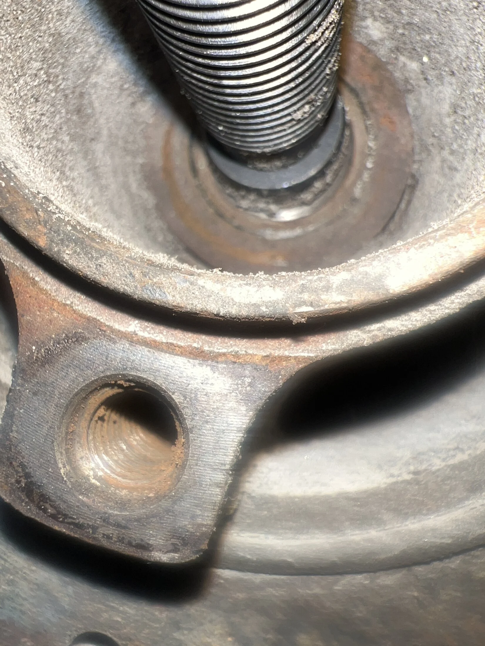

Something isn’t right here. It should not be this difficult. Looking at the picture where the puller snout rests on the end of the crank it looks offset.
Is it possible the puller snout is overlapping on the damper hub just a tad? If so, that could be your problem
Well now that I have the impact on it I am able to loosen it without spinning so yea I’ll try removing the tool completely and reinstalling it

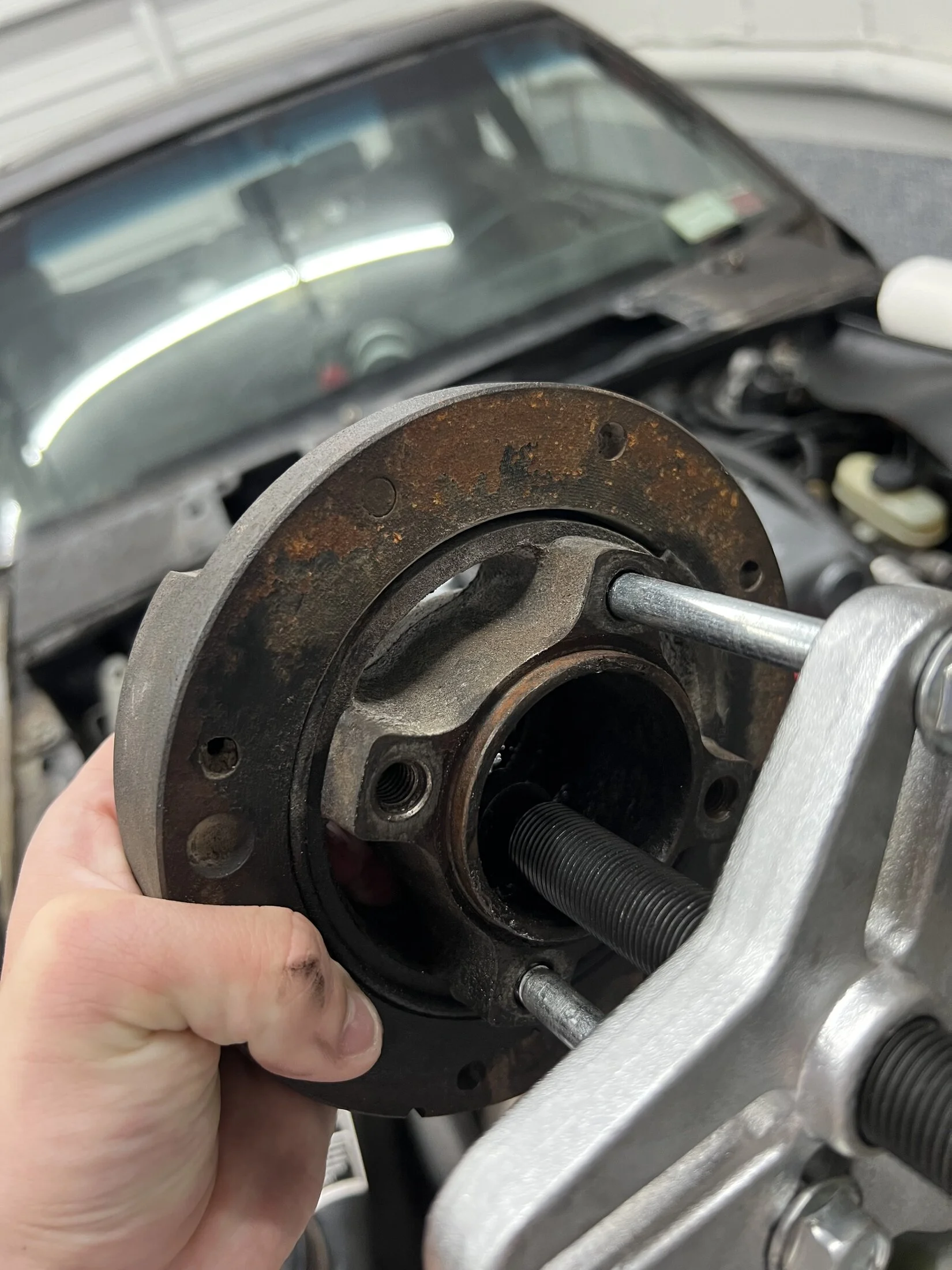

What I usually do is remove the crank hub bolt, take the washer off and screw the crank bolt back in most of the way. I then rest the puller snout point in the center of the bolt head to start the pull. If the bolt head will clear the hub diameter you can continue to pull it all the way off. If the bolt head won’t clear, after beginning the pull you can then back off the puller and remove the crank bolt to continue the pull. Using the bolt screwed into the crank will protect the threads and crank snout from getting deformed by the puller

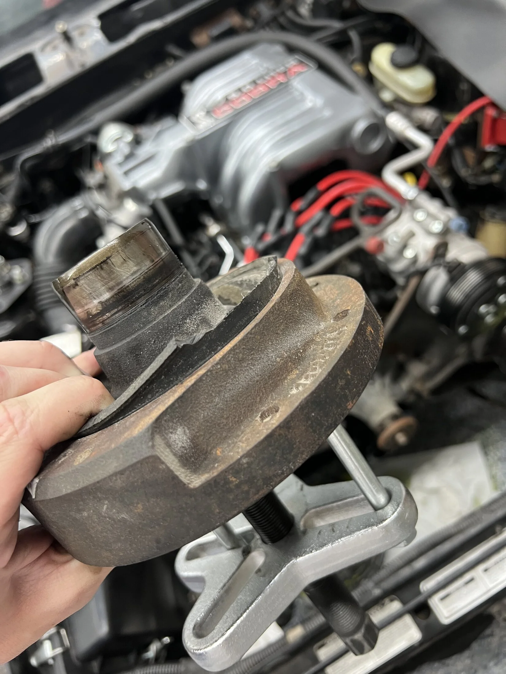

Put the tool back in with that washer out and recentered it on top of the bolt and the balancer came out so easy with barely any force on the wrench. Thanks a lot guys for the help. Hopefully it goes smooth with the installation now haha
