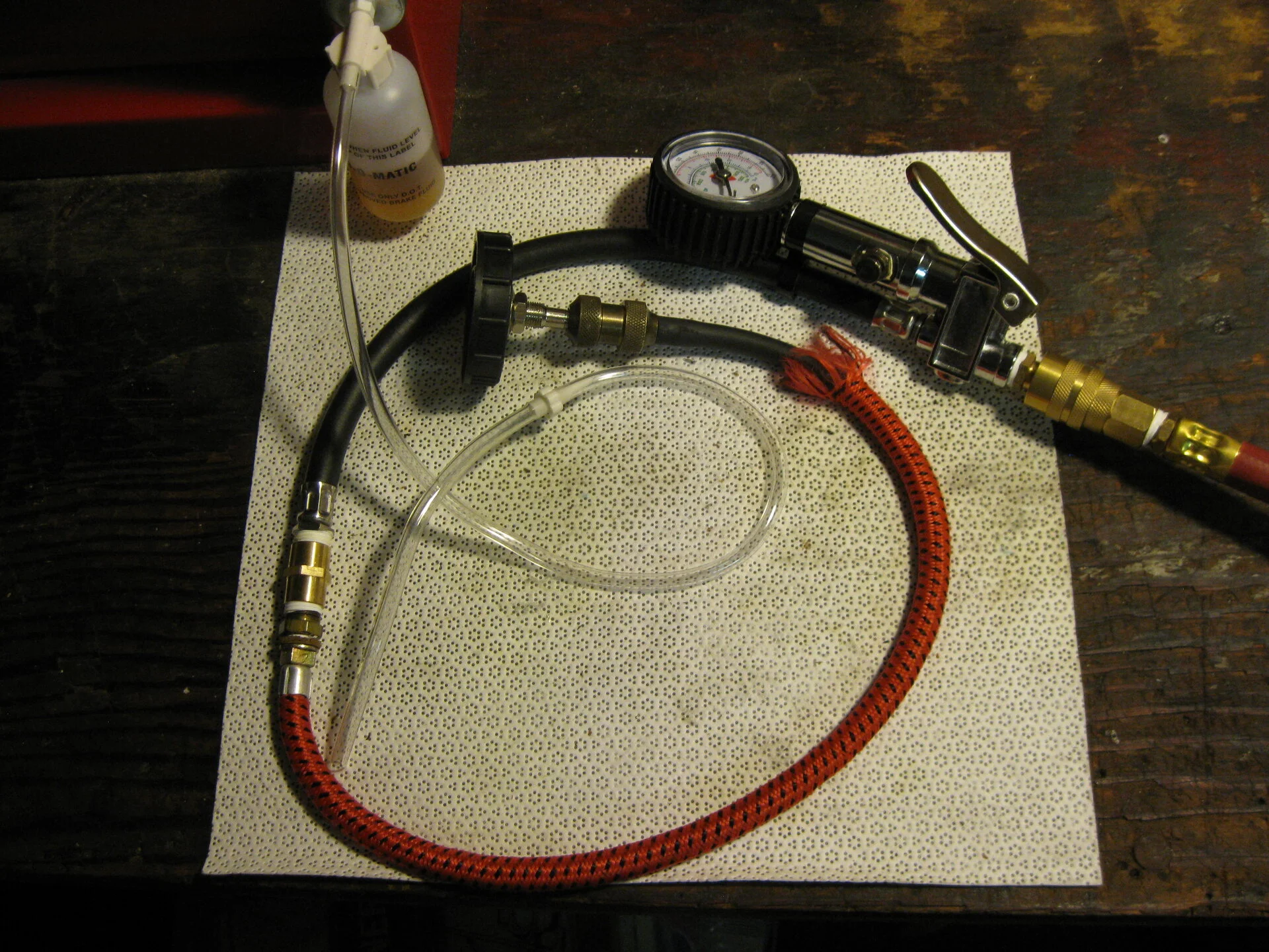

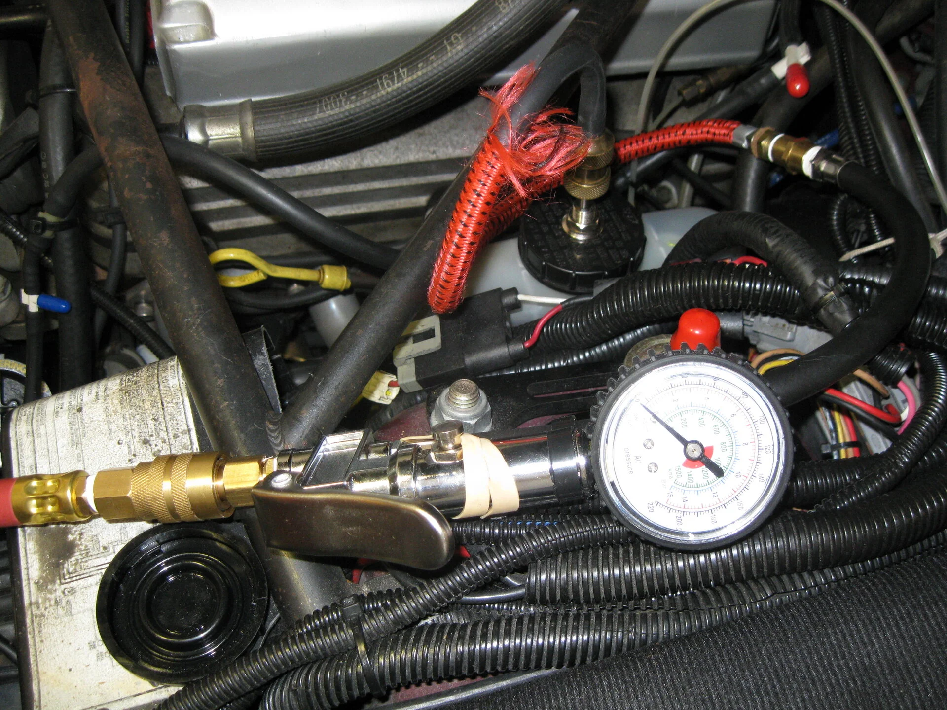

1-man brake bleeding is easy with an air compressor & a fitting for a spare fluid reservoir cap.
Dial down the pressure all the way & let it leak around the cap. Less than 5psi will push the fluid to the bleed screws.

I have a similar kit, forgot what it's called, but works great. I hope I can remove booster without disconnected brake lines, but it looks like a very tight area.

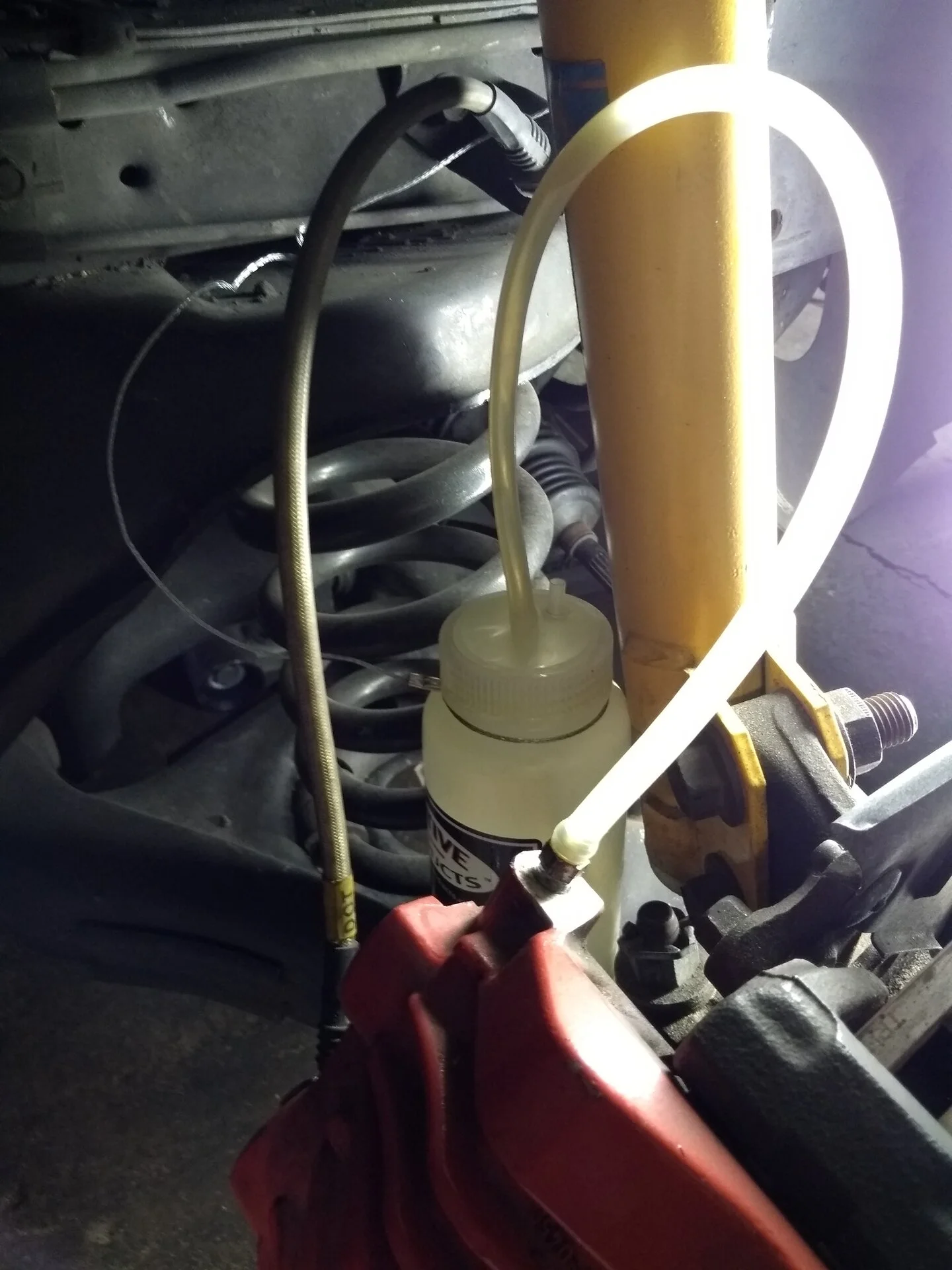

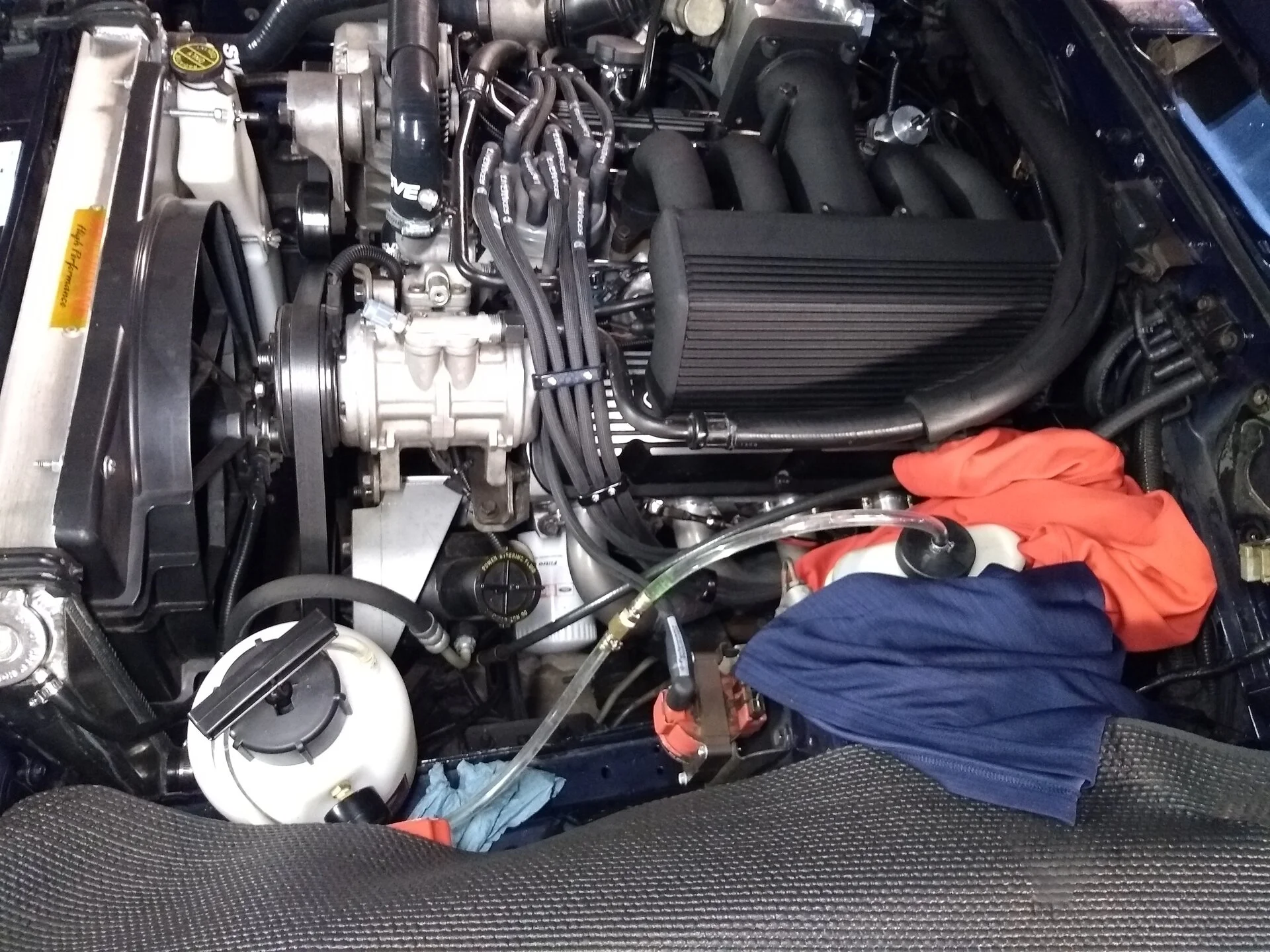

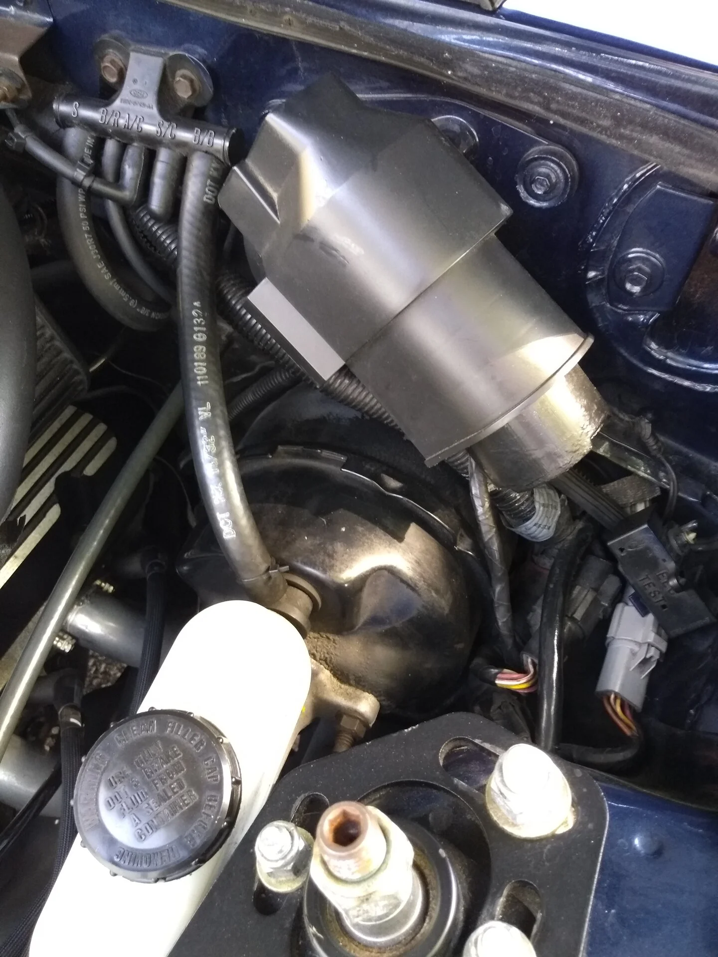

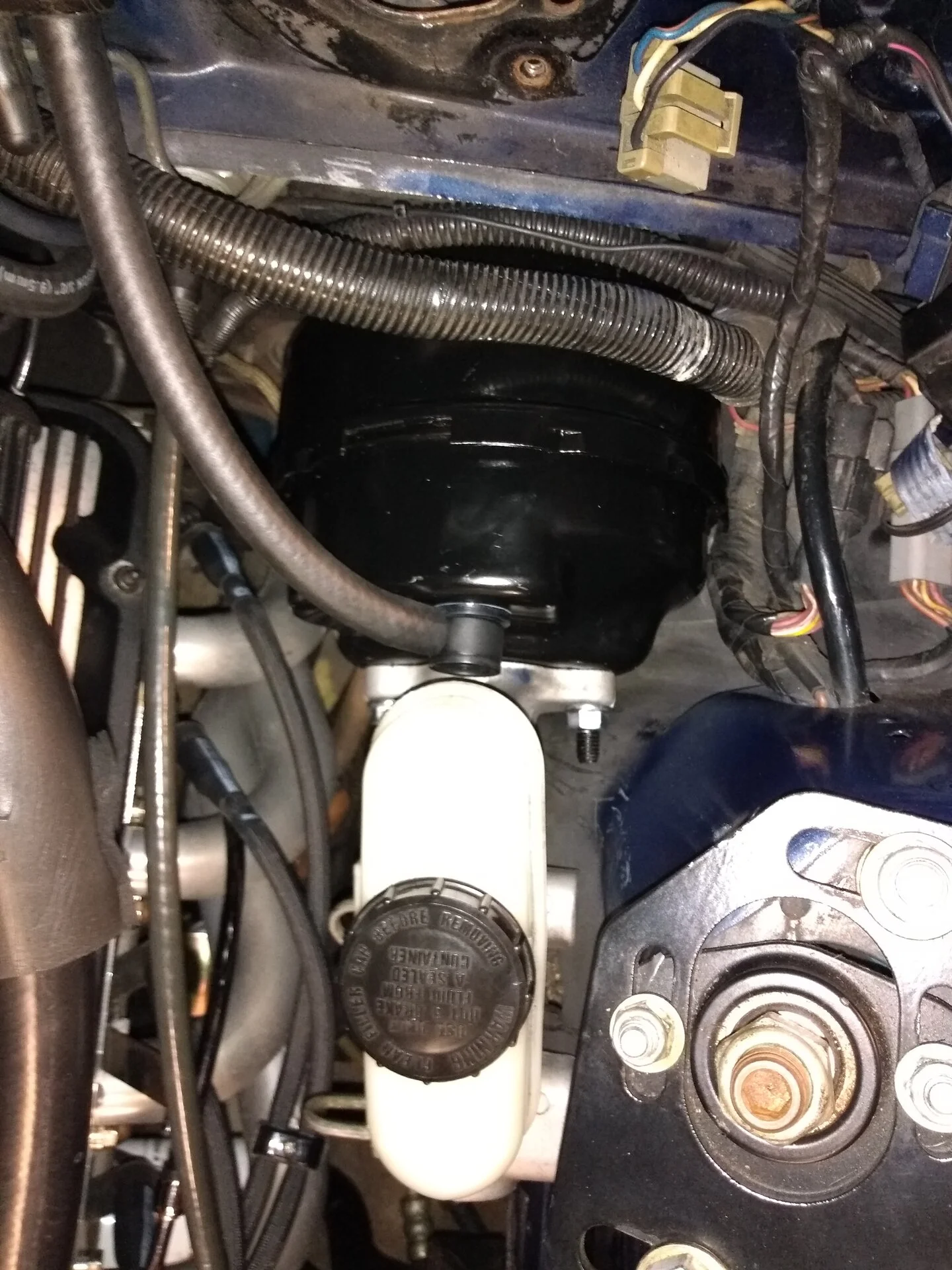

Got it all done yesterday. I didn't have to remove the lines on the MC.
Brakes feel good, no more hissing sound when pushing on brake pedal.
