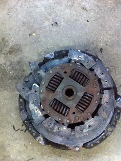

We had a guy come in who more-or-less did what you just stated, but he did it while going up hill with an already weak clutch. This is what ended up happening to it :D

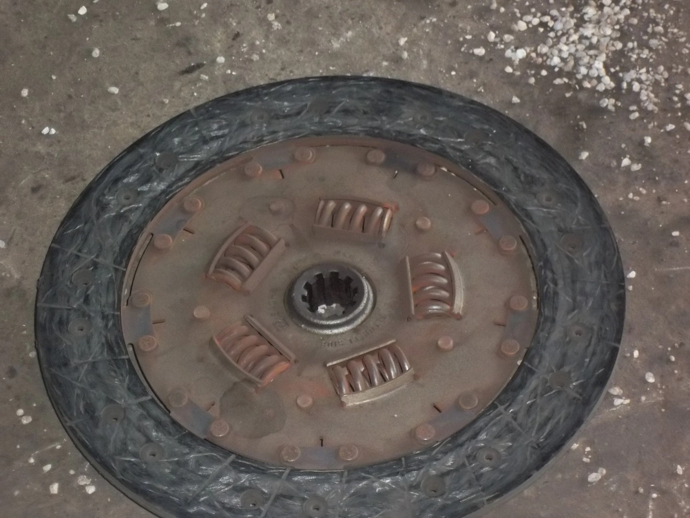

update #2... 06/22/2016 ... drove this glazed clutch for 2 years. it wont easily hold 4th or 5th gear. the problem now would seem to be bogging it in 3rd, 4th or 5th... at 97k miles... so hit your switch and fly or replace the glazed clutch immediately. or buy a used Ferrari, same deal. lol

The clutch disk looks a lot like the one I recently replaced on my Mustang. When the disk looks like that, you need to replace the clutch disk, flywheel and pressure plate all at the same time. The heat generated by the slippage damages the flywheel and pressure plate to the point that they cannot be successfully be machined to clean them up. The clutch disk. pressure plate, flywheel, throwout bearing, pilot bearing, bolts & dowel pins was about $425 from Summit. Shipping was free...
