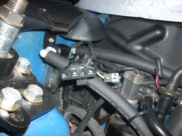

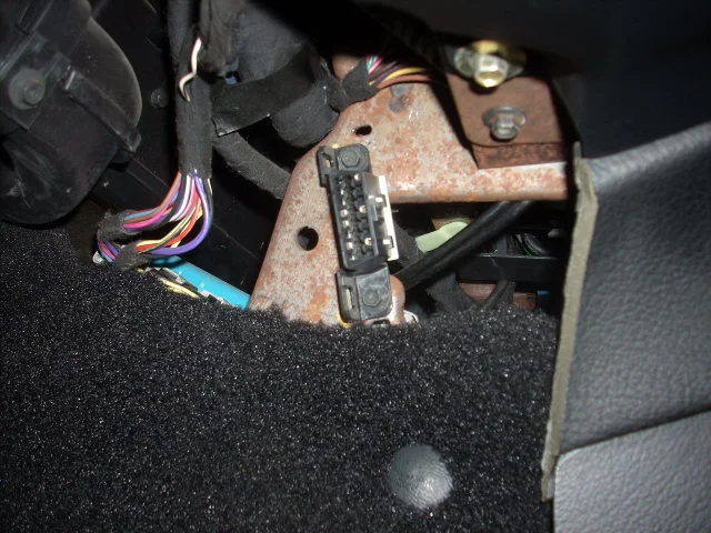

There are 2 diagnostic link connectors on the Mustang. One in the corner of the passenger side in the engine bay and the other inside the driver side, The one in the passenger side in the engine bay is the EEC port, which I jumped to read the flashes. The one in the driver side is the same size as an OBD 2 port and my OBD 2 scan tool plug fits in it but it won't read. When I bought the car, I was told it has a fox body computer but I'm not 100% sure if it does or not. I'm thinking it does because it has the EEC link connector in the passenger side of the engine bay and I'm pretty sure that is not factory.
The 94-95 GTs have the OBDI port on the passenger side engine bay. The OBDII port is for the V6 for those years. Ford found it cheaper to make a common harness for these two years.
