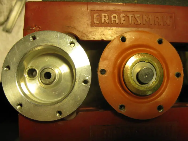

I have a Kirban FPR. The diaphragm has a check valve (anti-siphon valve).

I kinda wish I didn't order a new one. Didn't know that they can be rebuilt. Looks like that part is around 30 dollars? I could always have my old one rebuilt and then keep a spare.

It should look exactly like the picture.
Raised & bubbled, not good.
Need pic.
There's a small spring behind the metal piece.
