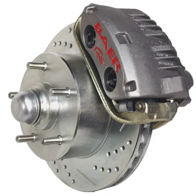

i am pickin up a set of these brakes for my notch. i am swapping him my front stock brakes, i need to make sure we swap parts properly.
i know the spindles are modified, we are planning to swap spindle/hub, rotor and caliper. we are each keeping our brake lines. can anyone who has seen/installed or knows this kit verify if that will get me setup?
any info helps, thanks. i am trying to get ahold of baer also for instructions currently..
If i remember correctly, the 13" kit uses the same PBR caliper as the 94-98 cobra, but the rotor/spindle setup is obviously unique.
If it is the same caliper, then you need to trade brake lines too. The Fox lines won't bolt up to the cobra style PBR
I can't find anything on baers site. Ill just swap lines too. Does anyone know if it changes wheel offset at all?
Prob not because it uses modified fox spindles.
It should look something like this
