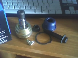

SPicer sells replacement ball joints for our cars (s197's) they list it as 05-09 ball joint kit, part number on the box says 5051322. I called spicer and they will not sell to the gewneral public, but they do make them and I believe are they are suppliers from what I have been reading. they are related to the brand family mcquay-norris family of chassis components. I believe they supply ford with some parts as well. so I paid $150 for both from my friend who bought 20 sets for his mustang club in Costa Rica.
