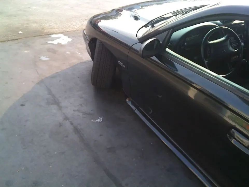

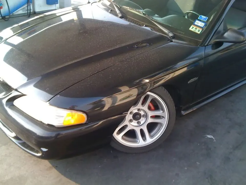

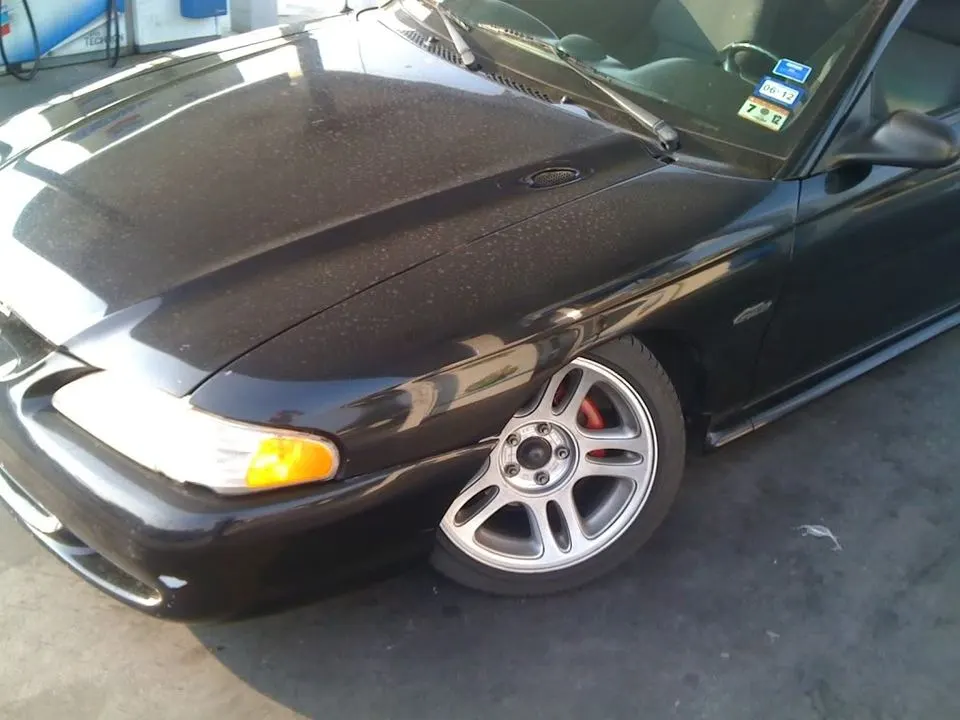

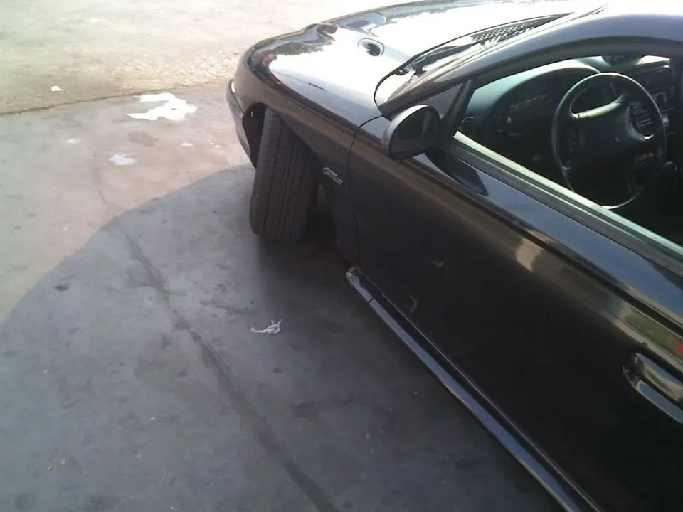

Do it, before this happens...

I agree, get the Moog ones, or another set of aftermarket ones. Hell, if your car is lowered, just get a set of the Steeda ones. I havent heard a lot of complaints about them. I wouldnt get them unless I had something like this where I actually needed to buy a new set.
