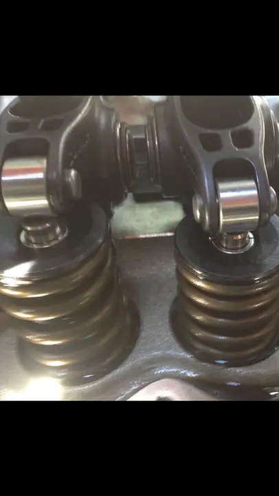

smkshw said:
this is how the engine builder has them,kinda all over the place also?...you guys tell me?
Yeah, they're clearly angled as a result of the GPs trying to "close up" in the middle.
I encountered the same issue w/ the hacked up plates I had to make for the Monster. Try dealing w/ two studs that are angled in different directions, using a guideplate that had to be cut and sectioned.
Have you tried to slowly tighten each stud, then ck by setting the rocker on and adjusting the guideplates if you need to tapping them w/ a drift punch after you get it tight enough to hold the adjustment?
I was just about driven crazy by the last one on my head, because it would move just as I got it tight enough to really crank on.

RangerJoe said:
Nice choice on the rockers! Are you using a little moly lube underneath the base of the stud? That should help it turn a little bit. If I remember correctly, I had to adjust mine all a little differently. Also, I was advised to use thread sealant on the studs that are open into the ports (intake I think).
Joe
thanks...i didnt want any more issues!
squeak93 said:
That rocker on the right looks out of alignment. I'd be afraid of causing undue stress on the spring and getting coil bind or breaking it. Use the moly trick listed above under the studs to tighten them to spec w/o binding the brackets/guide plates.
yes my thoughts exactly!?
im new to this internal stuff but ya i was thinking of tightening them just enough,then putting the rockers on and and adjusting them that way,then re tighten and hope it dosnt move?,all the info i seen has a solid plate and looked a lot easier! ....im a little worried now..lol,ill try again tonight thanks guys!

another reason i stopped was the thread sealent?...what kind you guys recommend?....sorry for all the questions im learning as i go
squeak93
Jun 2, 2005
2,282
370
164
Joplin, Missouri
Jun 25, 2015
#45
  • Jun 25, 2015
  • #45
ARP makes a good thread sealer and also a good moly lube. Just about any quality brand will suffice though.

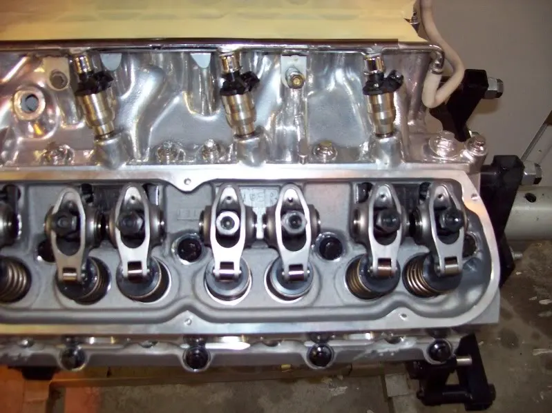

My rockers pigeon toed like yours heres a pic from my build i was a little concerned but i have almost 25k on engine now and all is good and my engine was built by rick from rnh per.
hmm?...thats how mine look exactly?....and those arnt adjustable plates?

i think i got the hang of it...takes a little but its doable!

ok....if anyone is still reading this,i lined them up perfectly,half turn from what i thought was 0 lash,and a snug at the end after tightening the lock nut,i was tempted to go more because my valves sounded like the typewriter thing before,it sounds identical now so i hope i got it right?
anyway its gona be back in the road today,ill make sure all is well then i can continue with the sc plans!
