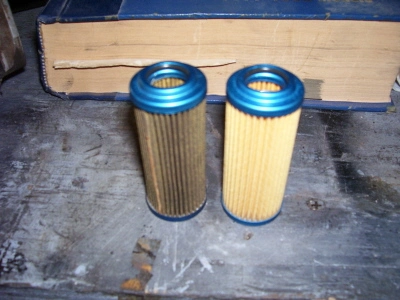

IT'S FIXED!!! ....and I'm an idiot
So, I changed out the coil, wires, cap, rotor, all to no avail. Then on a whim, I ordered a couple of new elements for my fuel filter. As soon as I opened it up-dead giveaway. Initially I didn't think about checking it, as it had only been in there for about 5,000 miles...but, see for yourselves...it's disgusting:bang:
