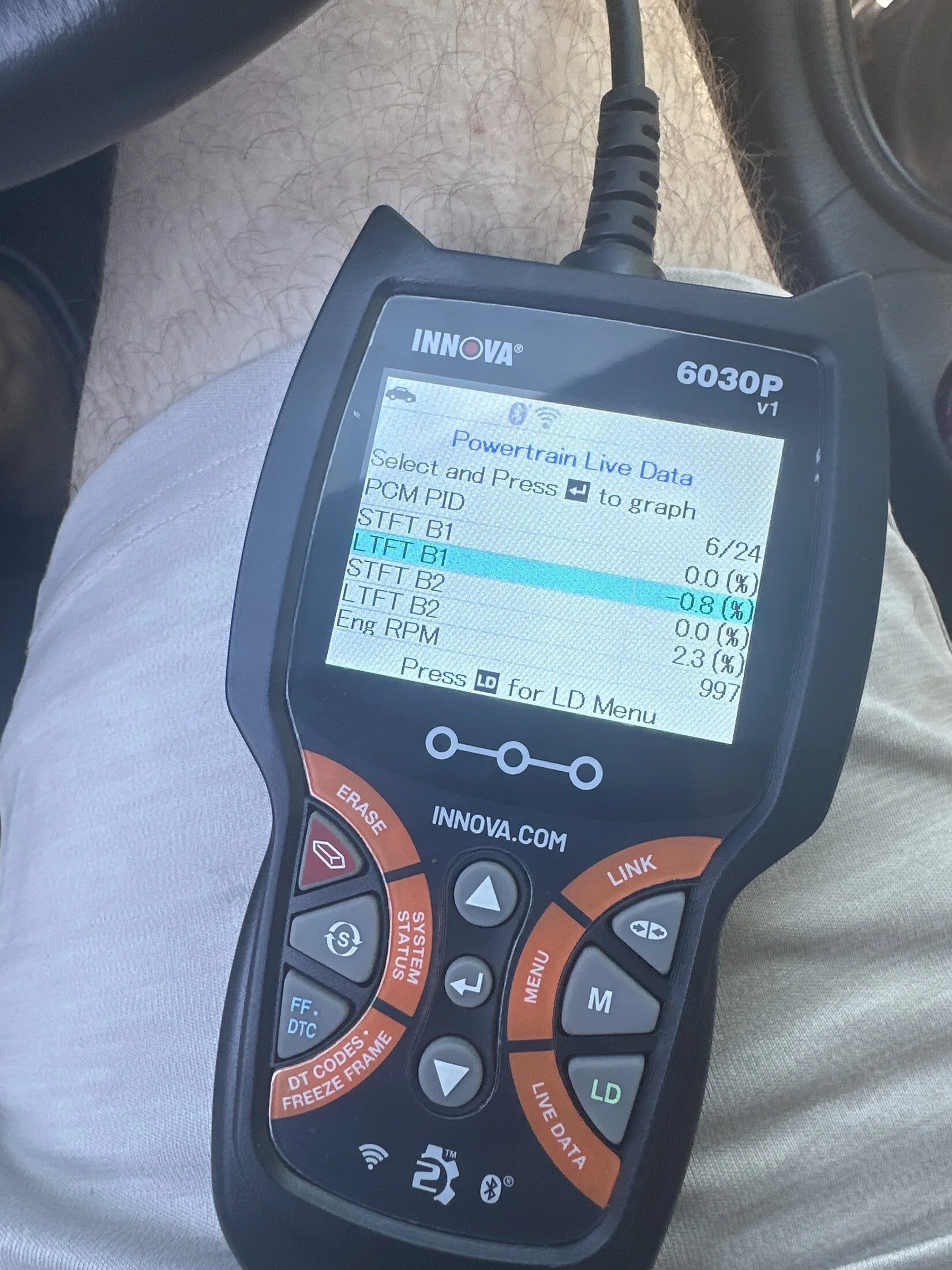

Replaced the Idle air control valve and Fuel Pressure Injection sensor and the fuel trims are looking good now!
Now i cant tell if i still have a misfire or if its the cams...Will SCT x4 datalog misfire data? Or do i need to buy an expensive scanner to get misfire live data?
Never got a code for a misfire, only the lean fuel trims on both banks. I need to check temp of both catalytic converters because before I was only getting 150 degrees on the bank 1 side while bank 2 catalytic converter was 450 degrees

Ok, i still have an issue.
I think the cat on the driver side (bank 2) could be an issue. Went out and let the car idle again and im showing a constant +22% on the Long term fuel trim for bank 2. What is odd is that the short term fuel trim does not go past +/- 3%. Even that said it still shows +22%.
I noticed Bank 2 Sensor 2 is getting 0 voltage. I dont know if the rears would have anything to do with the fuel trims. This is the only O2 sensor i did not replaced because it was seized up. It is plugged in though.
I drove the car around. The passenger side Catalytic convertor got up to temp (500-550 degrees). It could very well be the driver side cat has failed due to being lean without me knowing it....will post a live data graph below when its done uploading
Also the +22 lean on the long term fuel trim for bank 2 goes away after i start driving it a bit. It eventually goes back to an acceptable level. It seems its ONLY at idle.....
EDIT: maybe im wrong. The reason the Catalytic converter is getting so hot is because of the lean condition on bank 2. This is reported by the Bank 2 Sensor 1 O2 sensor BEFORE the catalytic convertor.....
Back to the drawing board, as I have no idea why the fuel trims are all of a sudden getting high, when before they were not...

Thanks for the detailed explanation. I am only getting p0174 now. I replaced both upstream o2 sensors last week.
I can reset the KAM with my SCT x4 tuner which may reset the fuel trims back to zero? I don’t think the innova can do that.
Would you say that my driver side catalytic converter needs to be replaced if I’m not getting p0420?
