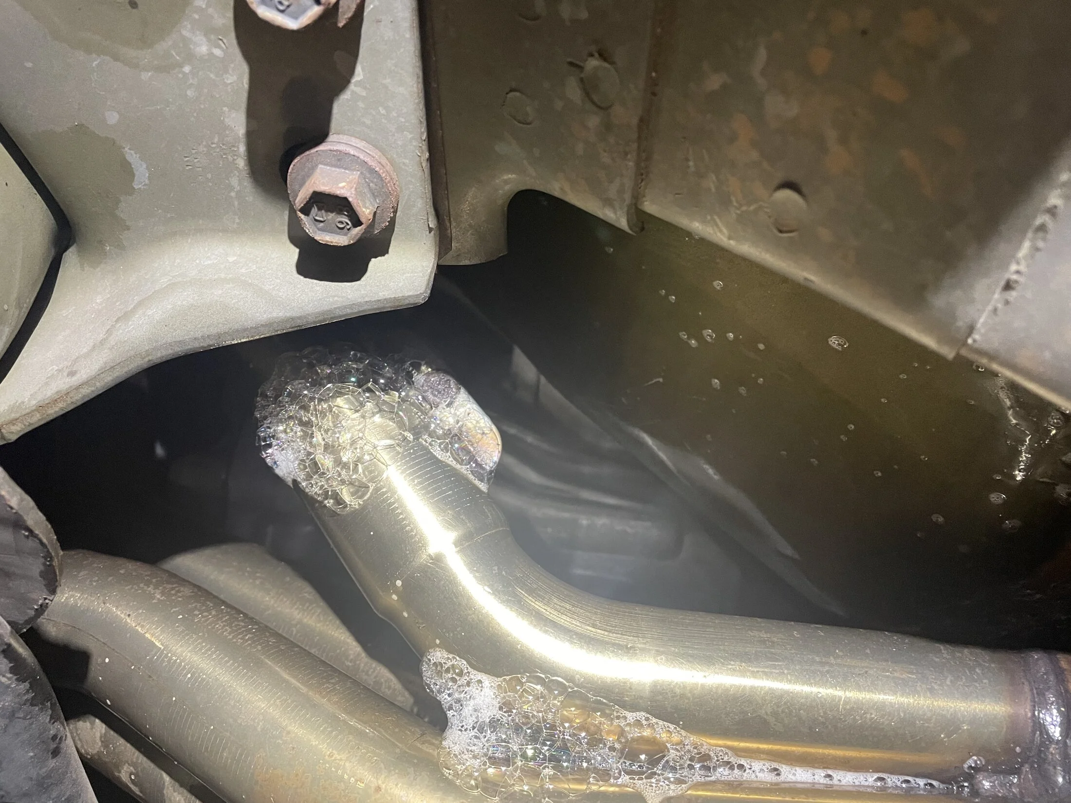

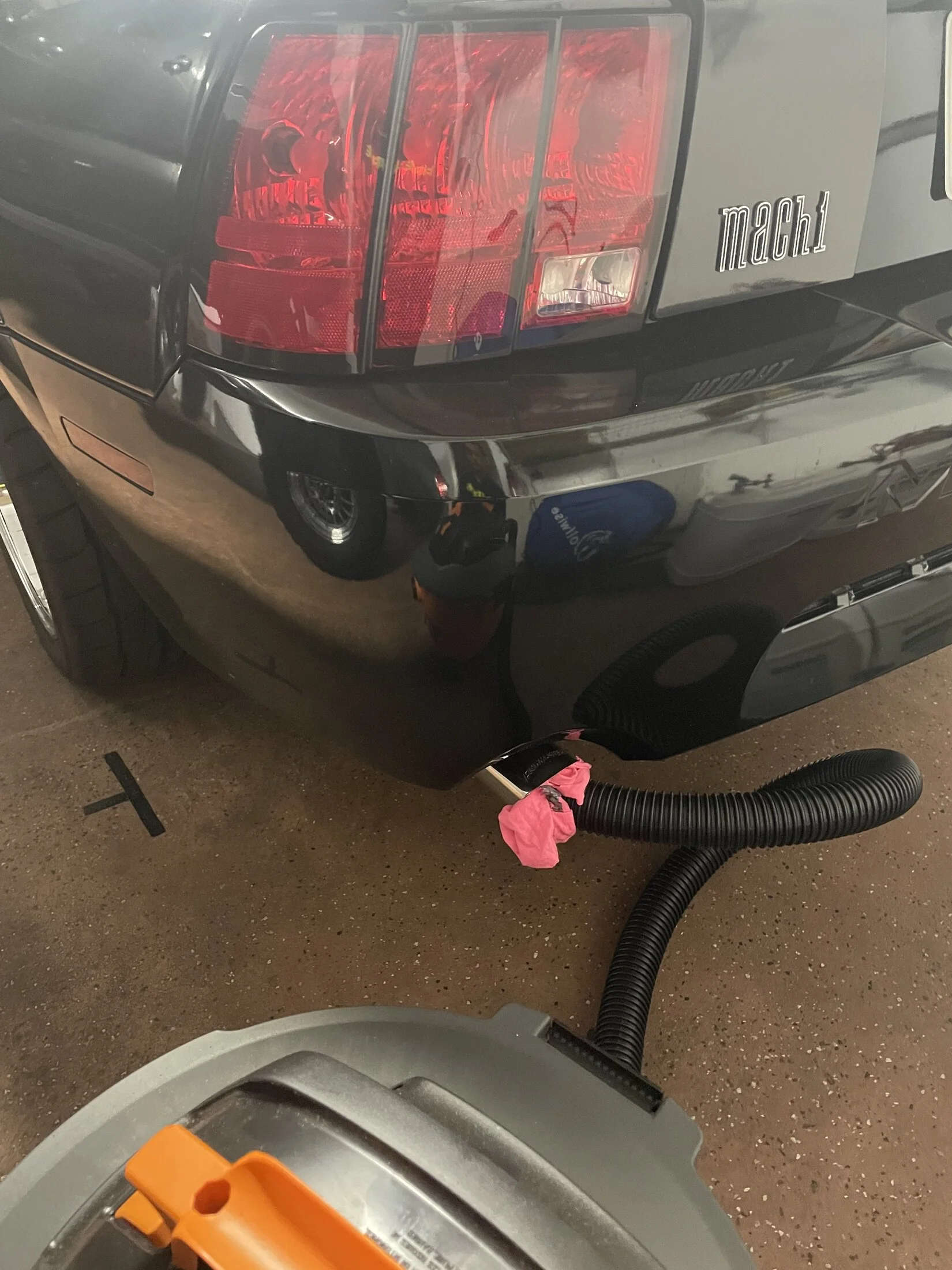

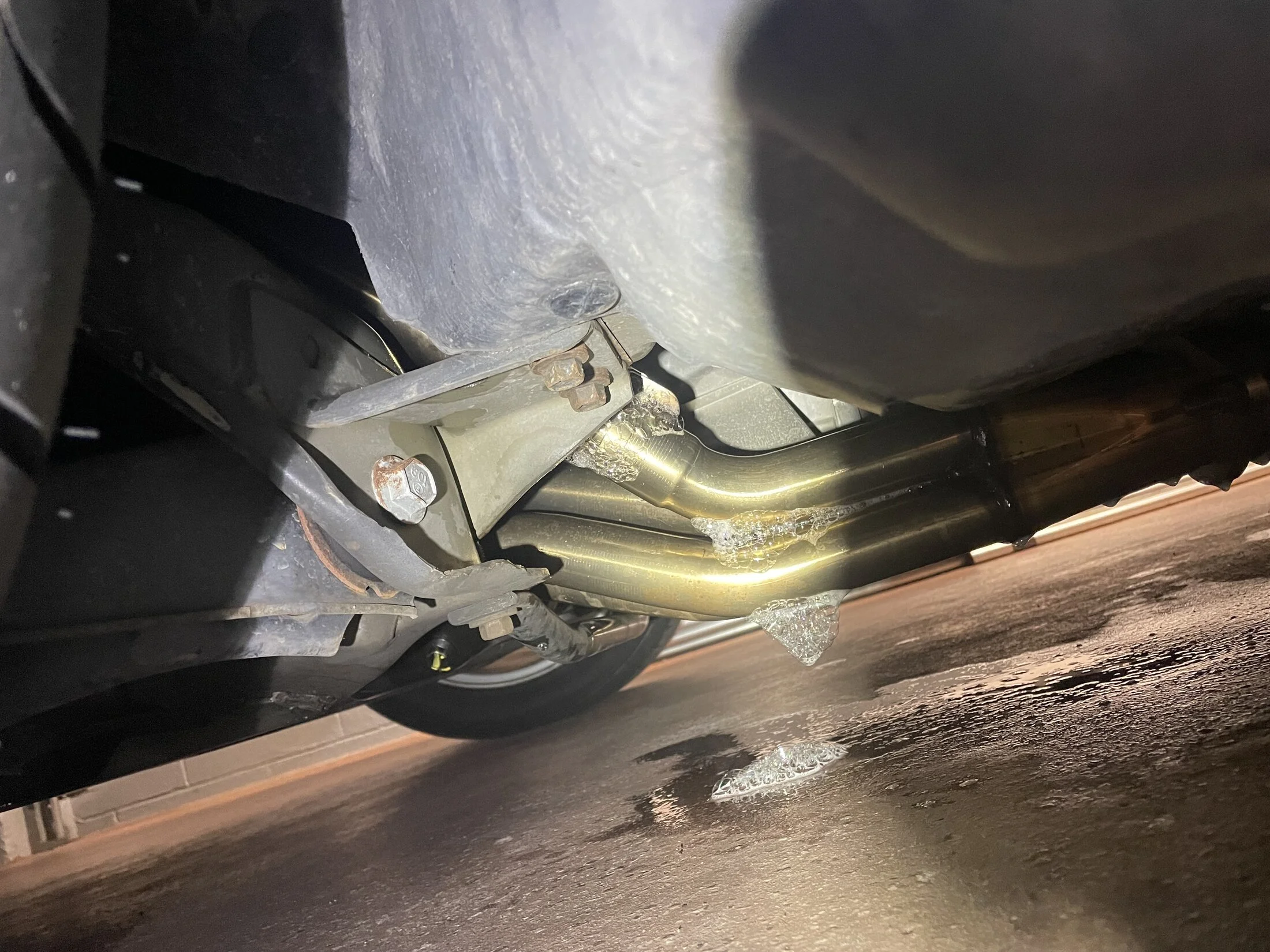

I tried to smoke test my exhaust - and found it difficult.
I ended up shoving a vac shop into my exhaust and setting it up to “blow”. I then went under the car and sprayed soapy water near the o2 sensors, where header meets the head etc.
this process was way easier

Thanks! I dont have a garage so i wasnt trying to do this without a lift.
I got the fuel filter replaced today and the exhaust inspected for leaks, no leaks found. I was able to replace the EGR the other day after letting PB blaster soak overnight.

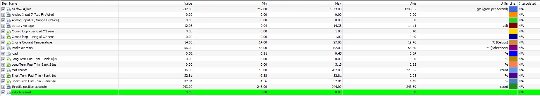

Alright so been monitoring misfires. Seems like ALL 8 cylinders are misfiring, some more than others......
Under load the misfires don't appear to happen. heres a datalog with fuel trims and engine rpm and well as misfires.
I still cannot determine if the engine vibration is the aftermarket camshafts or not, which the aftermarket cams could be causing a false misfire.
