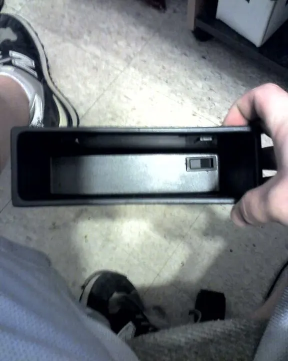

I found a good spot for the switch today.
You cant even see it when its in the car.
