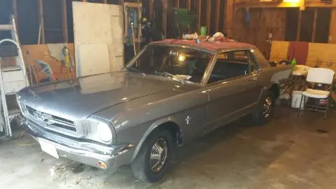

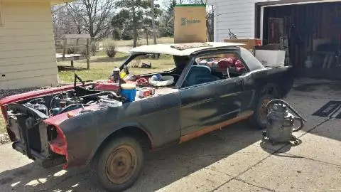

Hello everyone. Last October (2013) I purchased a 1965 Mustang coupe in a basket case condition.

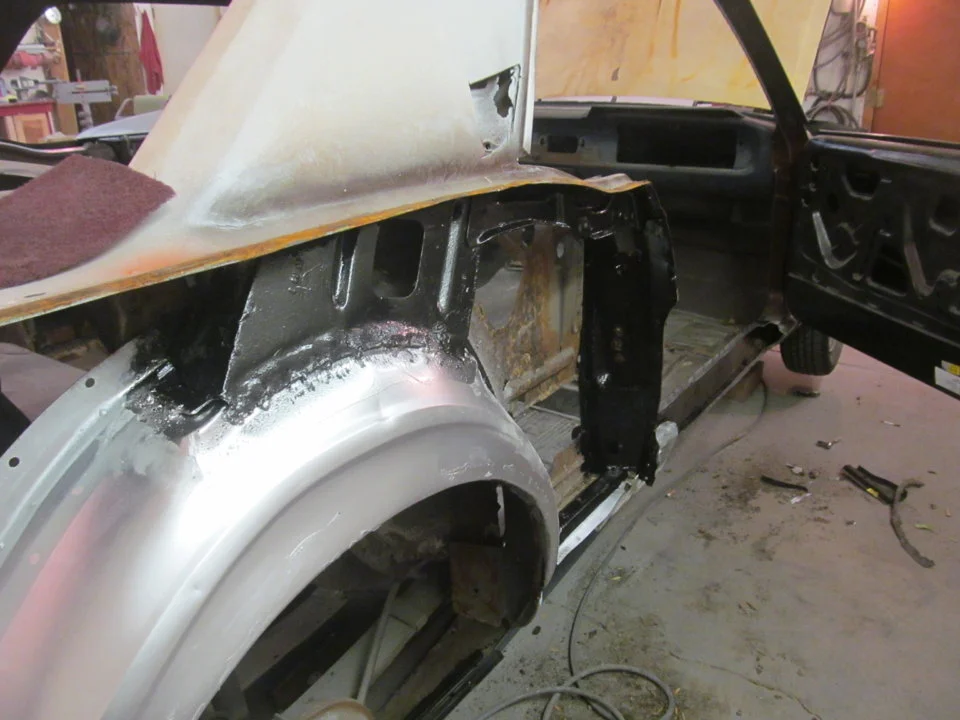

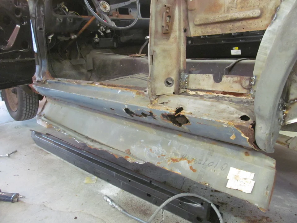

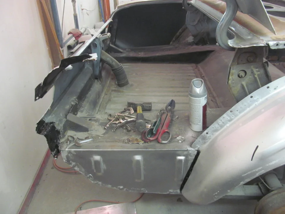

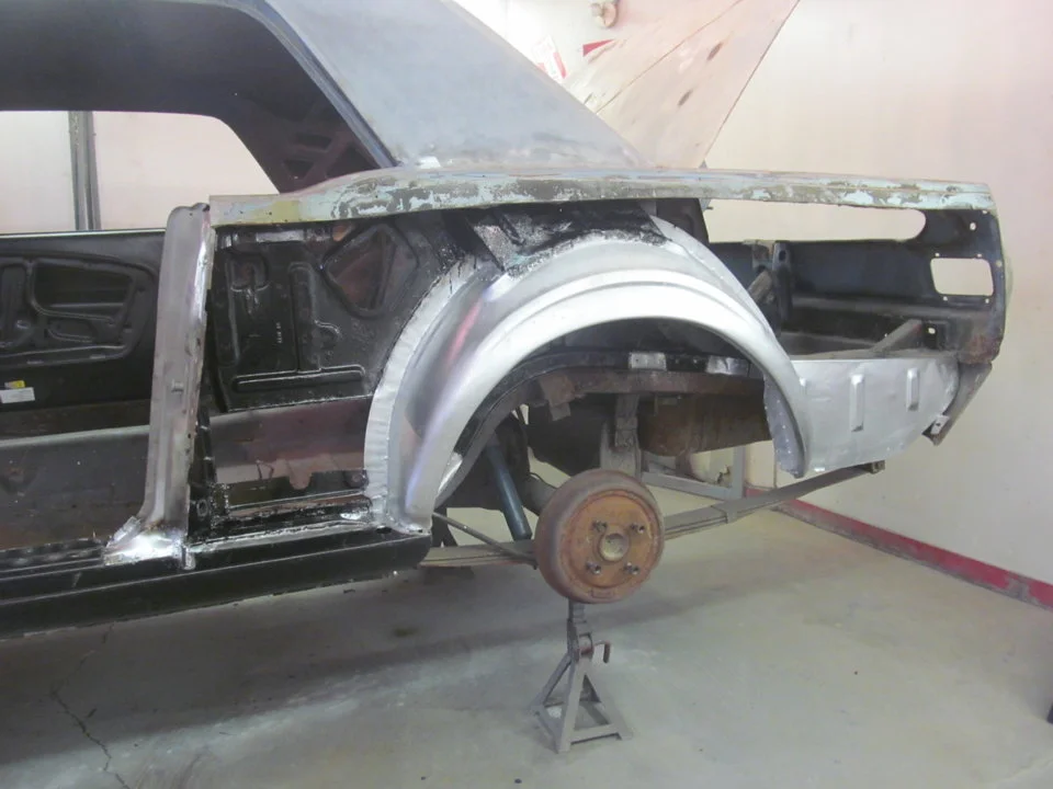

The car was purchased by the previous owner in 1992 and over the next 2 years he and a buddy tore it all down. They put new quarters, rockers, doors, fenders, floors, and engine compartment aprons. Most of the new sheet metal they just screwed on or tack welded it in a couple of spots. They rebuilt the rear end, front end, motor, tranny, brakes, and more. Then 1994 rolled around and the work stopped due to his buddies death. The cars had 4 or 5 moves from garage to garage and Kansas City, Mo to Des Moines Ia. Then the car sat for 21 years with no progress until I happened along needing a winter project.
I've put the motor and tranny in the car and piddled around trying to organize the boxes and baggies of parts and pieces. In May of 2014 I took the Mustang to a body shop where my body man proceeded to weld in properly the panels applying por 15 to the underside of panels and the car. Then he painted it titanium metallic grey. Since the return from the body shop I've been putting the interior in, glass, and trying to get it finished. #1

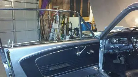

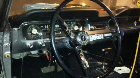

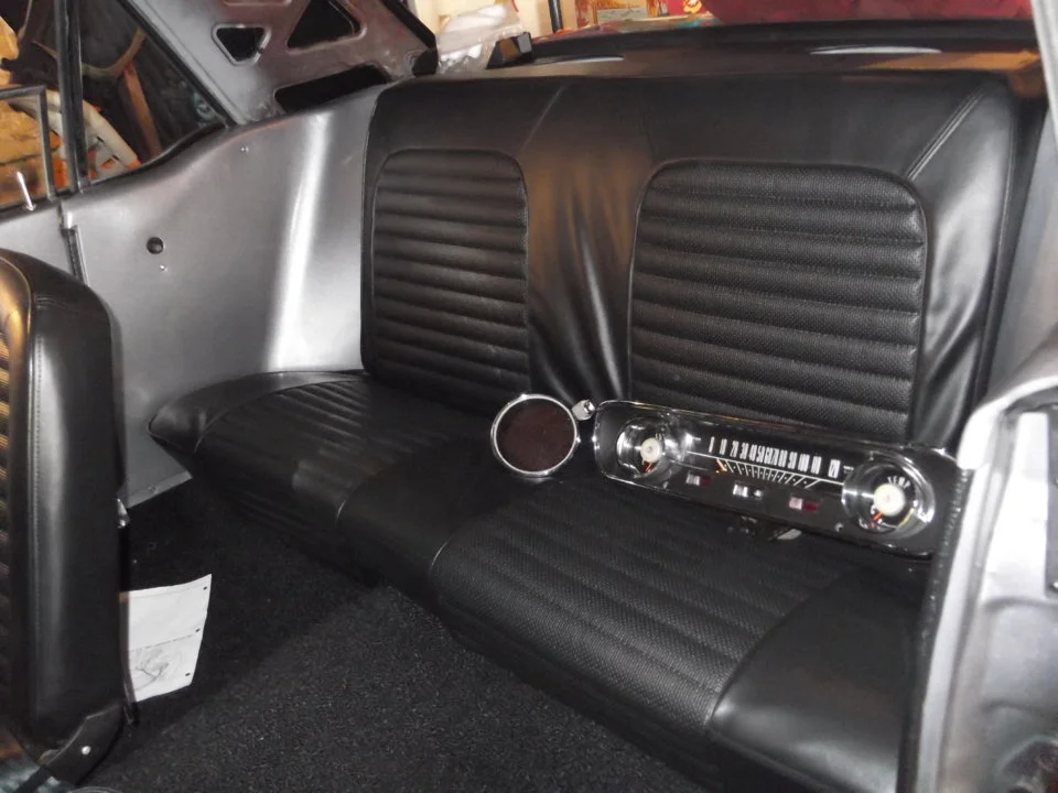

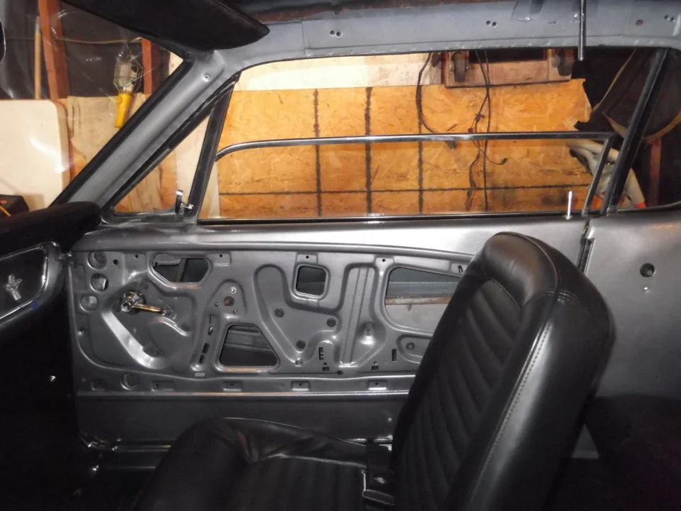

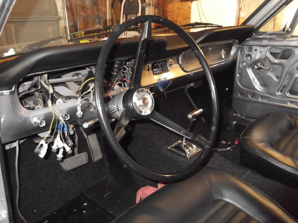

Thought I would post some progress pictures. I've been a little slowed with working on the Mustang because I got a brand new hip! DSCF3799.webp I got the carpet installed, kick panels, and most of the wiring for the dash sorted out. I'm still missing the power wire that goes to the back of the ignition switch. I believe is GONE and I will have to run a new wire from the fuse block. DSCF3801.webp All the upholstery is finished except the headliner which I plan on starting in the next few days. You can see on the rear seat the gauge cluster that I spent the $26 or so dollars for. Well worth it if you ask me. DSCF3802.webp This is a picture of the vent and door window that I've spent hours trying to figure out where all the pieces go. It isn't finished but I had to quit working on it or I would lose my mind.

Ok, over the last two days I've made some progress. I put new rubber around the vent windows so they won't whistle when you go down the road, I've sorted out some of the wiring issues, installed the package tray, rear speakers, radio. Then I installed the vent and side windows as well as the door cards. Then came the gauge cluster. I'm far from finished but gaining ground! I put new tires on my Corvair and will put the raised white letter BF Goodrich TA Radials on the Mustang with hubcaps.

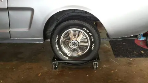

BUT before I could start this project I decided I was going to take the mustang to the grocery store. As I pull into the parking lot I hear a loud POP and I suddenly have NO STEERING! I limp the Mustang into a spot and inspect the steering box. Since there was nothing leaking I decided it was OK to drive it home. WOW, was that an adventurous ride. Thank GOD it wasn't very far. As soon as I pull into my driveway I hear another POP and the wheel spins freely to the right. I put it up on car dollies and pull it into the garage.
