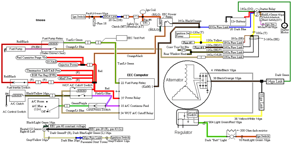

Fuseable links are a wire that act like a fuse. When they get overloaded, they
open circuit and do not pass current. The alternator fuseable link is in the wiring
harness connected to the starter solenoid. If you are not skilled in automotive
electrical work you may find this difficult.
See the following website for some help from Tmoss (diagram designer) & Stang&2
Birds (website host) for help on 88-95 wiring http://www.veryuseful.com/mustang/tech/engine/
You will need an ohmmeter or DVM (Digital Volt Meter) or Multimeter to measure the resistance of the fuse links. You will need to disconnect the positive battery cable to make the measurements. You should see less than 1 ohm across a fuse link.

so how would i go about fixing it if it got overloaded?
When a fuseable link overloads, it blows just like a fuse. You have to split open the wiring harness at the starter solenoid, locate the bad link, cut it out and solder a new link in.
If you are not skilled in auto electrical service, I recommend that you enlist the help of a friend who is skilled.
