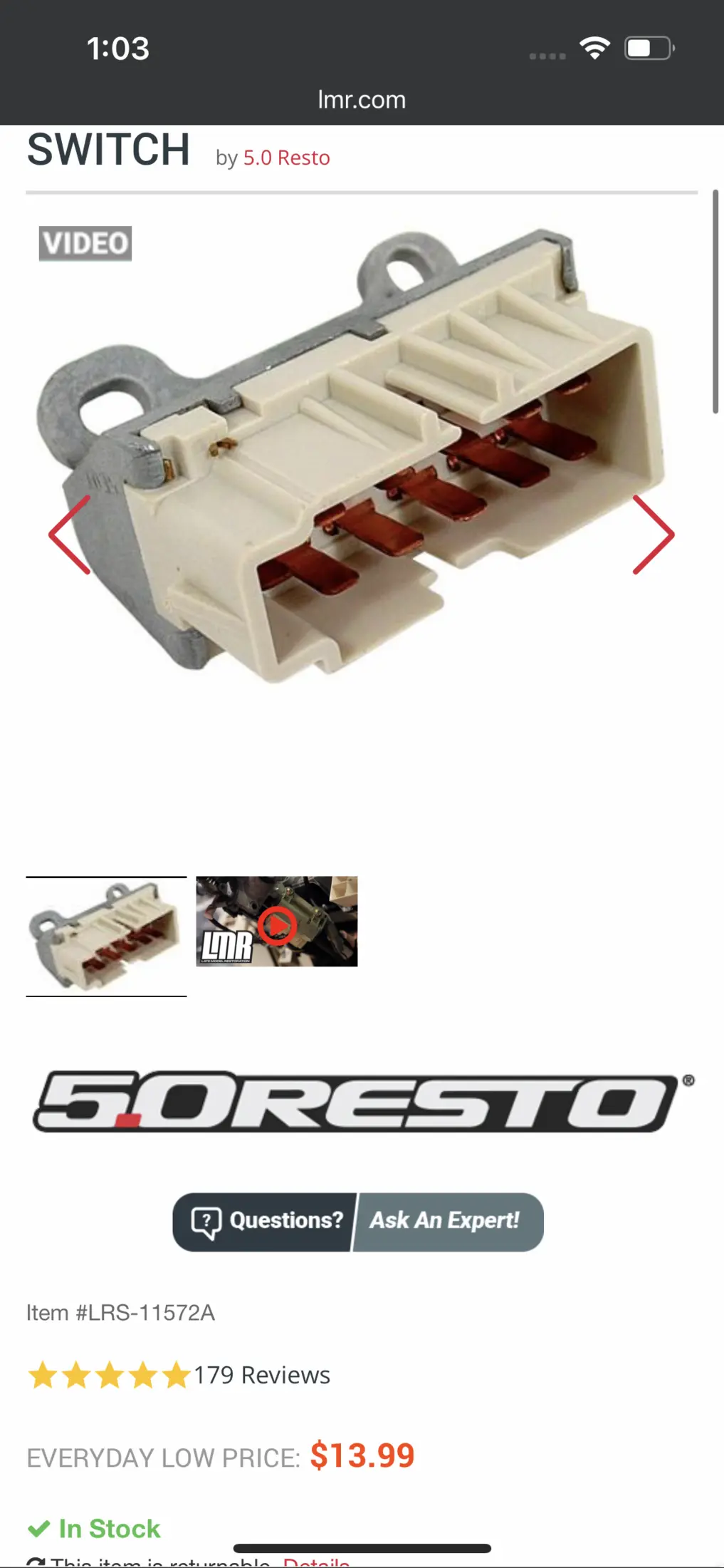

If you mean this one yea i just bought a new one like 3 days ago.I have battery disconnected cuz as soon as I connect it the cel light, battery light and the seat belt come on. I just swapped the switch, the actuator and the starter soloind.I changed ecc relay. It still does it when I disconnect map,the key chime. I even have the fuel injector harness not connected to the 10 pin. Also disconnect fuel relay, wot relay. Also when I disconnect the ecc(computer) the cel light goes away but I still get the battery symbol all with no key. I just disconnected the gauge cluster and the lights cel and battery and seatbelt) and I still get the fuel pump primming. It’s as if the key is in there in the koeo position. I called the tech but I was busy at work my boss watching me and by the time I got out it was closed. As for the fox guys in North Carolina no answer to my email test scince Sunday. I haven’t cheacked the fuse links yet. I don’t think it’s the alternator (cuz the battery light) because the fuel pump primes so don’t think that’s it.

Installed a whole bunch of switches back when they were recalled
Easiest, best way I found was to leave the new switch in the on position
That is the one right next to the spring loaded start position
Then, turn the key to the on position and install the switch
Bolt it down and double check the adjustment
In other words reinstall the actuator rod in the position before the spring loaded on position or the ignition switch?
I would disconnect the battery, move the electrical switch to the 'run' position, where it springs back from start, install rod, install key switch in run position. Count positions turning key back (counter clockwise) it should have two positions, all the way back should be accessory, one position forward is off. Hook up battery, check function.

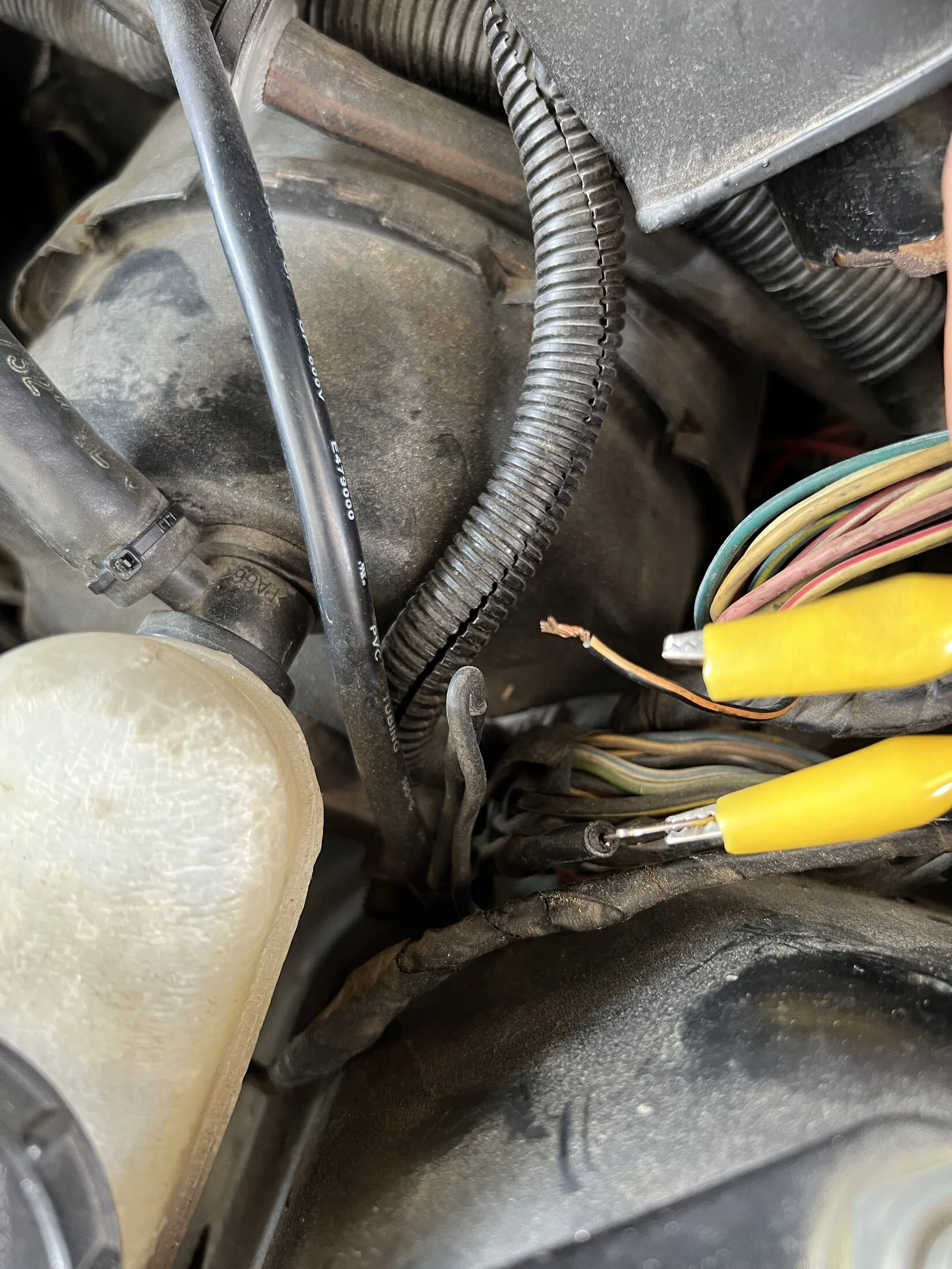

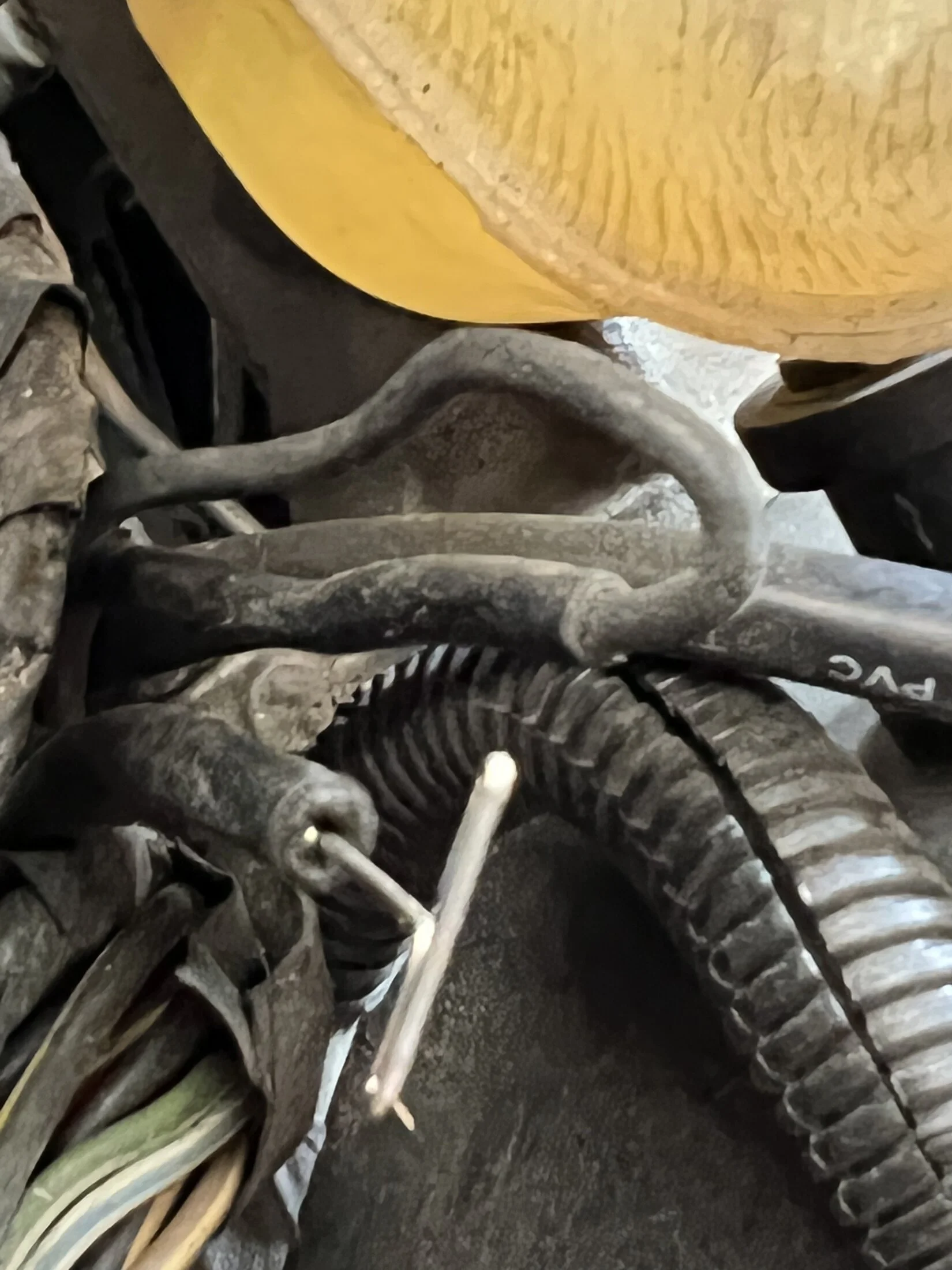

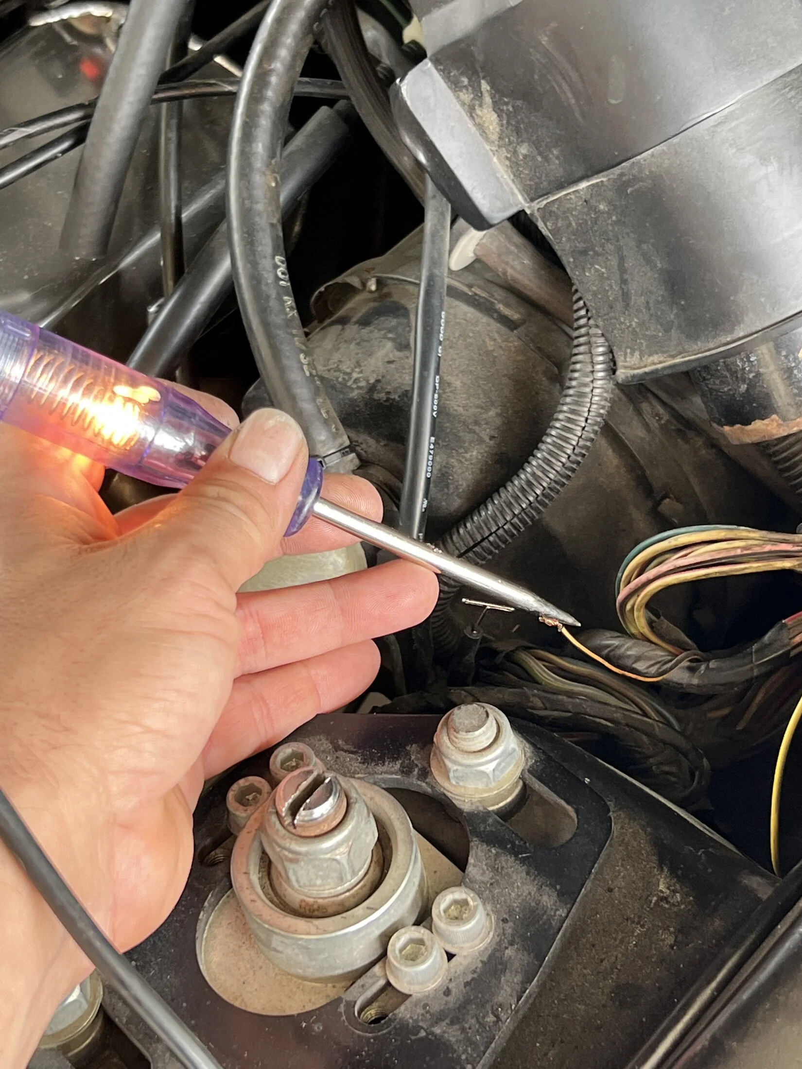

It wasent that. It was a wire a black and orange wire I had with a t pin on the drivers side harness. I know it’s a hot wire. I had it connected from the black orange wire to a t pin in a fuse link. I had it like that for years and when I took it off the lights went away. Absolutely don’t mind sending you something thro PayPal just shoot me a email adress for it. I appreciate you .I remember that I used to get a cel light when I didn’t have it hooked up.Shoot me ur PayPal I’ll shoot you some cash for your time. What do you think it’s for ? I can’t find it on wiring diapram at least I see 2 black orange wires on there but not sure which one it might be.I think I had posted the issue of that wire here while back. Ever scince I had the car that wire wasn’t connected so I thought that’s where it went. I think the cel light went away then.

That wire may go to the hood light, the wire would be there with or without the light installed, I believe there is only two wires like that in that area, the other is for jumping the fuel pump,

Jumping the fuel pump ? The wire is hot. I had it in the t pin location for couple years and not it’s causing car dash lights to stay on . Can that be cuz one of those 2 fuse link looking things went bad? I’m over here now looking for harness info online
