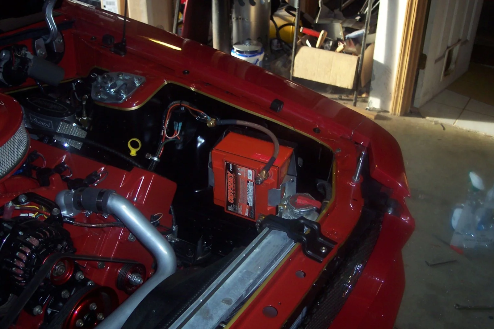

This was where the Odessey battery lived in the red car. Couldve mounted it anywhere, any angle. The brackets are purchase-able already made, and the battery is sealed..no venting required. ( I love this engine compartment,..gives my inspiration to do something similar on the current car.)

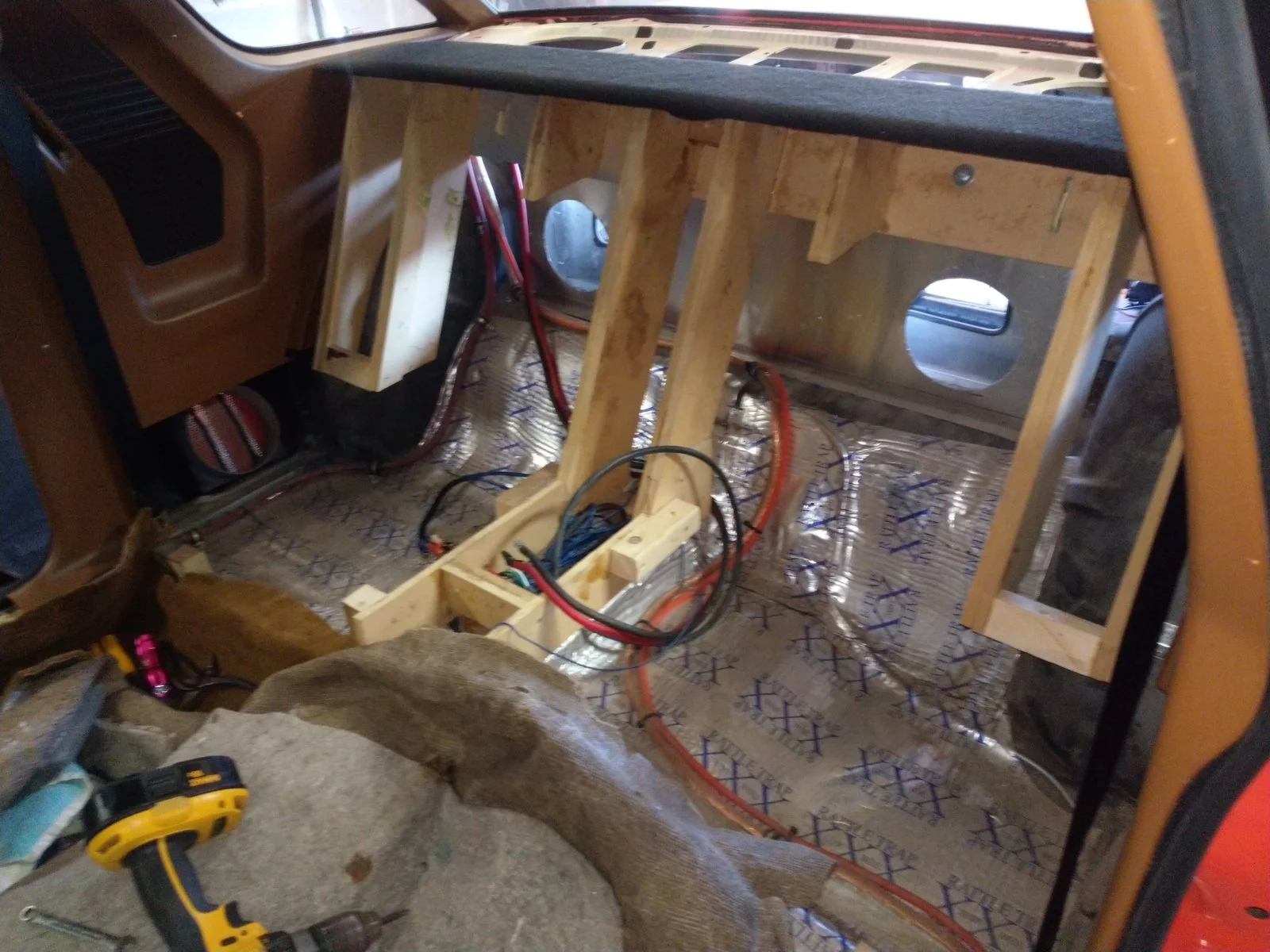

I also ran 1.0 cables inside the car on the current project for both 12v and ground, so that I could provide battery ground to the engine and ecu.
Easy enough to route it along the inside rocker to the front of the car.
