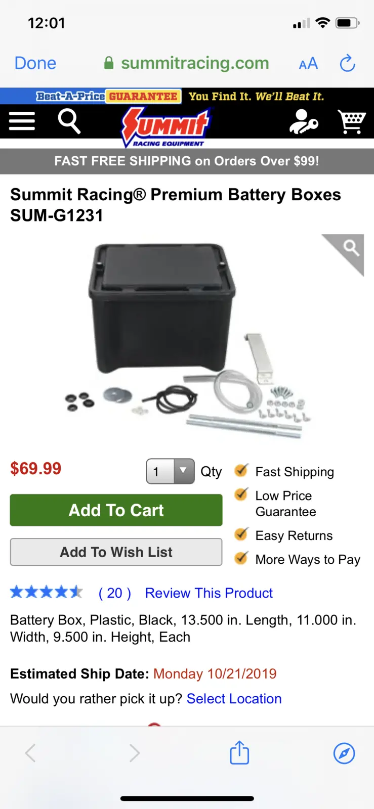

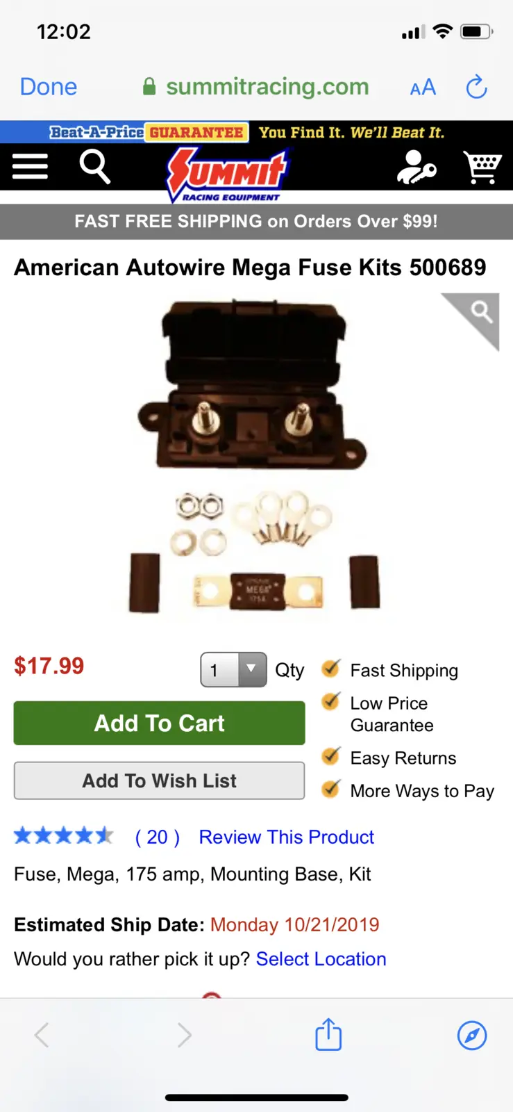

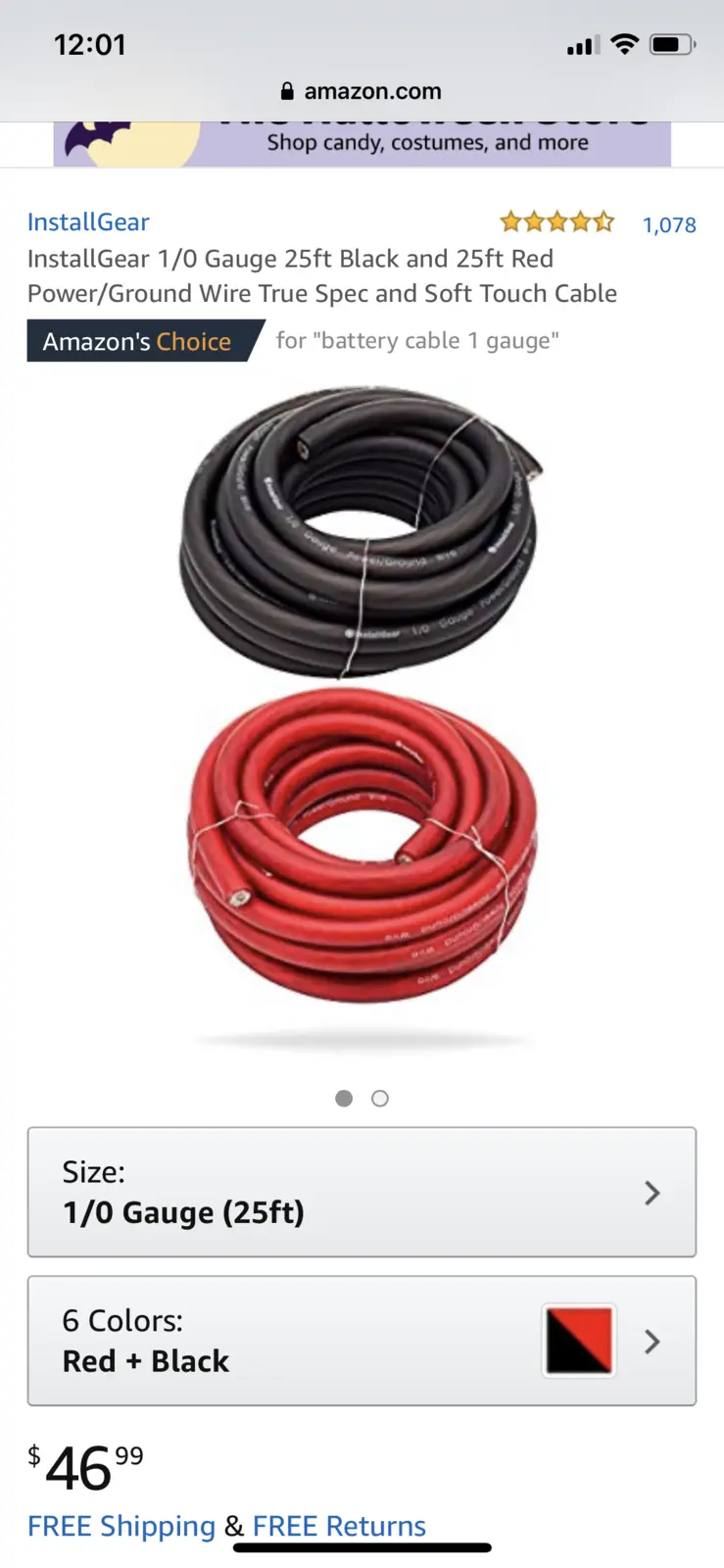

Ok I'll revive this thread. I'm about to pull the trigger on the stuff I need to move the battery to the back of my LX Hatch. I see the kits with the aluminum boxes but they dont include full length neg cable and they're like $170. I want a neg cable all the way back to the block. I figure I might pick and buy my own pieces. I'd focus on better cables and connections and less on fancy aluminum box. For these choices linked below I'm in at less than $90. I know I'd still need clamps at the battery posts. I have the tools and means to solder and crimp the eyelets. Some heavy duty zip ties for routing cable are already on hand.
But what do you think of these choices below?
Cables
Eyelets
Marine Box

OK thanks, I see the smaller size now. Still deciding but I think the black box might look better in my interior with it's other black trim.

To answer your question as far as cable size . Remember especially on a full street car with all the working accessories you really can’t go wrong with over kill. A 4ga wire is not enough. 1/0 or 2/0 is a great choice . The longer the run the less amperage it can carry , so your 4 gauge becomes inadequate at that point .

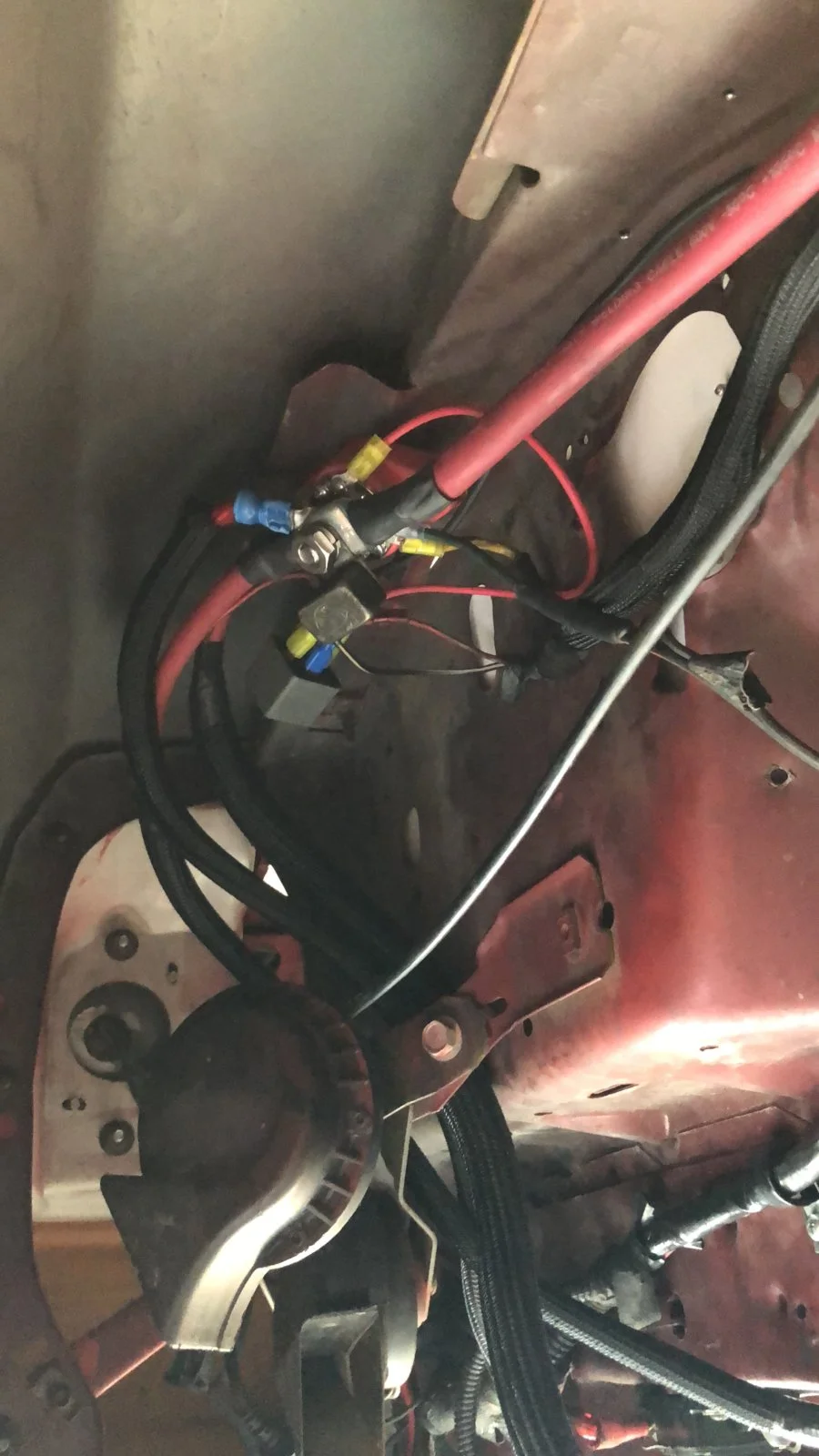

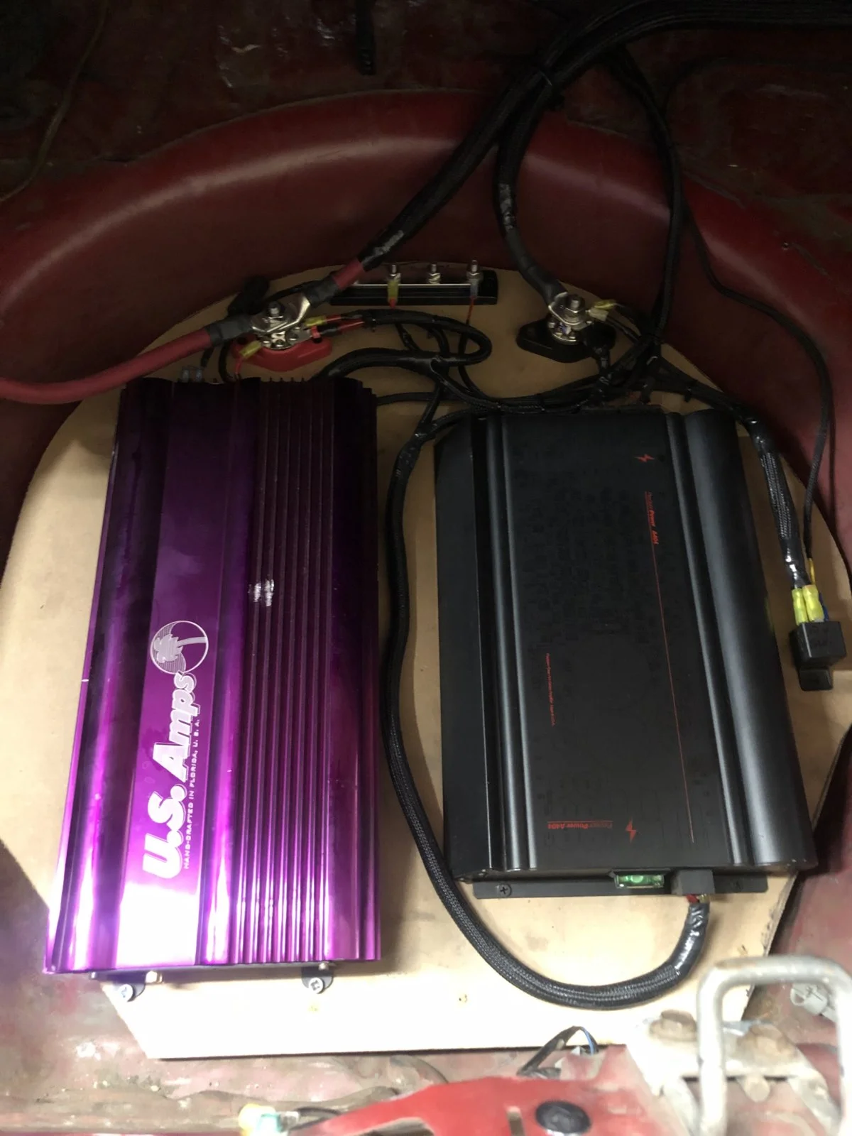

I have 2/0 from my battery to a junction in my trunk to power my amplifiers and some other stuff . From that junction it’s ran under the carpet to the grommet in the firewall for the cruise control.
Then to one more junction block to replace the starter sol . This powers the lights , windows , etc . I replaced the starter sol. with just a relay because I have a mini starter . From that junction I have 2awg welding cable to my alternator with a circuit breaker and also 2 awg to my starter .
I have a solid state battery switch as well . So I have a small push pull right at the corner of my plate. The nice thing with this setup is no heavy cable to the switch itself . Just uses a 12 ga wire to trigger the heat sink / solid state and that’s it . With this setup you could run multiple switches and have one even upfront to kill the battery
here’s some in progress pics of when I was doing it to give you an idea .
