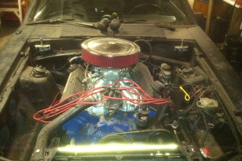

Yikes... so you're running manual brakes with a master cylinder intended to be used with a brake booster. I'm guessing that the booster was removed due to clearance issues?
yea when my dads friend built it in 2006 he used his old mud truck motor and just threw it in with the summit BBF swap kit. and what didnt fit he just took of the foxbody, and it doesn't help with it originally being a 2.3 so the brakes already suck for a V8 swap but this is what the engine bay looks like.

I honestly don't think that just installing a booster is going to give you what you need. It will only change the problem for you. Currently, I'm guessing that you have a really hard brake pedal and stomping on it with both feet just makes you bite off your fingernails until the damned thing finally slows.
Installing a brake booster with those brakes will have a similar effect but it will be brake fade. What I mean is that you'll get a false sense of security out of the first couple applications then nothing.
I recommend that at minimum, you step up 87 (I think it is) and up brakes. You can still keep it manual if you like, so long as you match it with the correct master cylinder (one that is designed to be a manual master cylinder).

Seriously, you need a set up for manual brakes. Besides what Noobz347 said, some cars change where the rod attaches to the arm for better mechanical advantage. But I do not know if this is the case in a Mustang. But be prepared to change the linkage push bar from the arm to the master cylinder too. I would hope it is in the kit.
That is the case. Early Mustangs with mechanical brakes had a different brake arm to change the leverage point. If you want to continue running manual brake,s you'll need to source some brake parts specific to manual brakes in a Mustang. The master cylinder will need to change as well.
Off the top of my head, i beleive an early mustang 7/8" bore MC with the associated brake pedal will be what you need. Finding a brake pedal is a different story. There may be aftermarket options as well. Maximum Motorsports is one lead. Be prepared to fork over some $$$ though

The 'old school' method of gaining manual brake useability is to move the pin on the brake pedal arm to a postition with more leverage.
Ford even did it, and many of their vehicles that were available with power brakes as an option, instead of standard, had multiple holes to put the brake arm pin into depending on power or manual brakes (some cases the pedals were different part numbers, but the only difference was the placement of the pin). If you move the pin higher up the pedal arm a bit, it will give you the leverage to make it feel like the manual brakes are plenty suitable for your car.
On the older Stangs, they use a Geo Metro brake booster in tight spots.
You might try to source a tiny booster that will either bolt directly on, or require very few mods to do so.
Just an idea. I don't know for sure, but it is something I wouldn't be afraid to try.
There is also a Ford that has a tiny booster, but it is not as easily installed on the 'classic' (60s-70s) Fords as the Geo booster. I think it was an Escort?
Something to look into if you want power brakes.
Oh, and there are some newer model cars that use 'hydroboost' brakes that people use for tight spots.
They use the power steering pump to assist the brakes, instead of vacuum. Good for big cams too.
Cobras and some Lincoln/Mercury cars used the HB, and it is tiny. Just has hoses run from the back of the MC to the PS pump.

I have no earthly idea if the Fox bodies have the same options, it was just a thought that would require more checking. I wouldn't be afraid to try, but that's just me. If the bolt holes lined up, and the booster was small enough, I'd 'try' it myself, but it will take alot of personal searching and measuring unless you can find someone else that has done the leg work for you.
Not only do you have to worry about the firewall bolt holes lining up, but also the MC bolt holes.
I believe the holes on the Metro booster are spaced correctly for the classic cars, but need the holes enlarged. Things like that is what you will have to contend with to find a suitable donor.
my dads friend said he read somewhere in a old magazine 2006ish that they swapped a 460 into a 85lx and they used a 93 cobra booster and it fits but barley. you cant adjust the driver side valves but you cant take the valve cover off but its a PITA.
Unless you swap the pedal out for one with a revised ratio, or change the MC...just using the adapter alone will give you a bad result as you've seen.
You either need to research using a different booster, or investing in a proper manual setup (matching MC and brake pedal assey).
