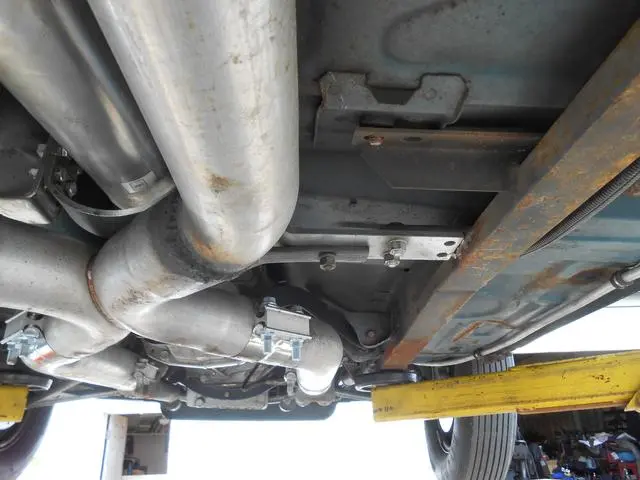

Had the car up in the air at a friends shop to change a speedo gear,snapped a few pics.

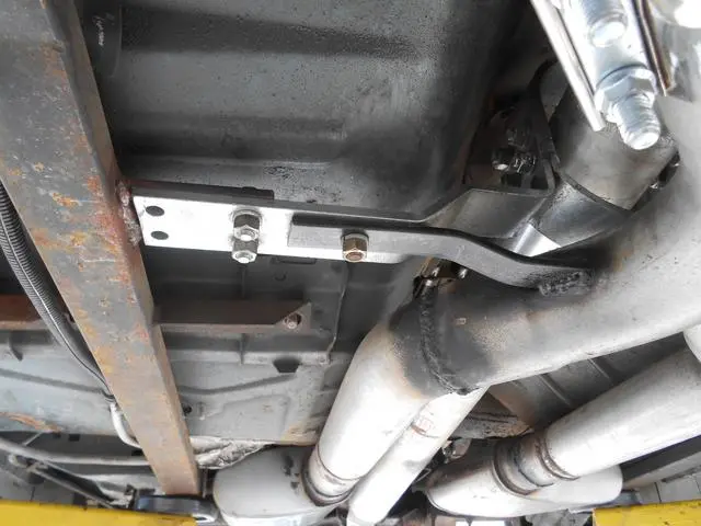

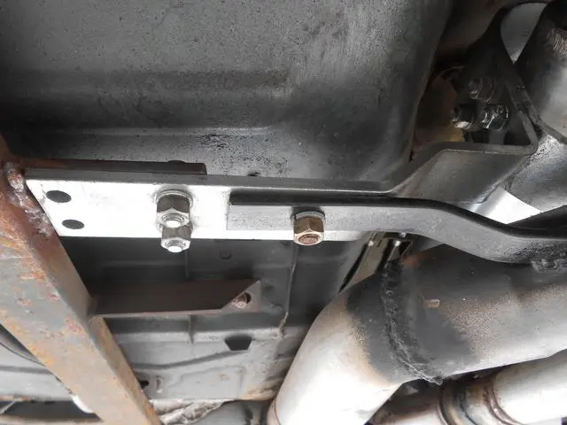

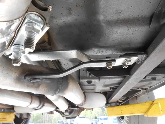

Nothing fancy,just some bent flatstock welded to the pipe and bolted to the d/s loop.
The bbk flange is 2.5''. If you cut the flange off,3'' pipe lines up pretty well with a butt joint band clamp.
I use a universal x,with hard mounts welded on each side. Not a bolt on,will take some fab work.
