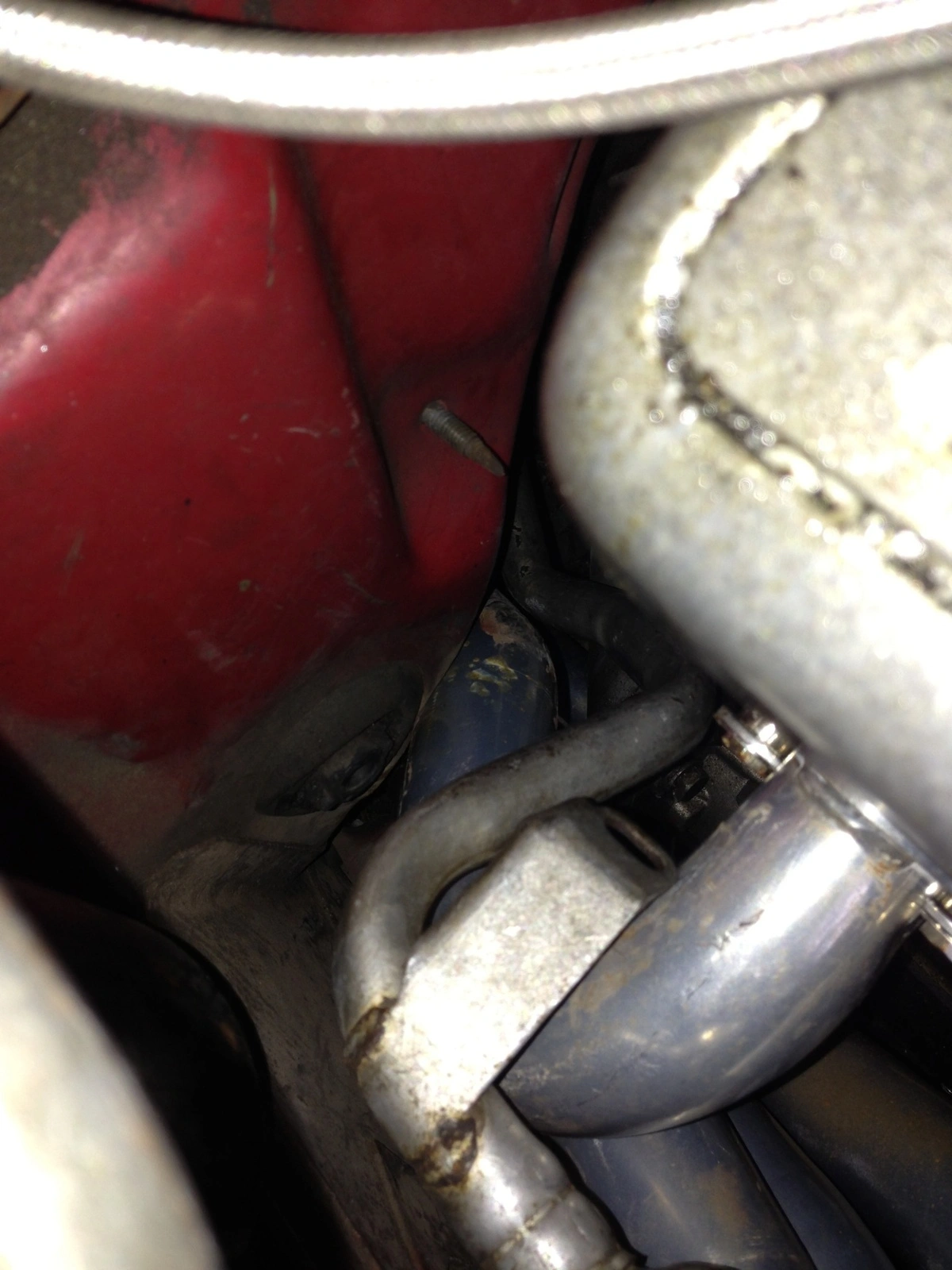

I don't believe the car was ever hit. All the panels have the original VIN tags, clean carfax, and straight body lines. No signs of any body work, original paint in the engine bay. If you could post a pic that would be great, and I will as well when I get a chance, probably tomorrow morning. I'm thinking it must be the motor mounts... For a car this clean I refuse to purposely dent it. I want to just make it right.
Never mind the oil and dirt, but you can see the header on the firewall.
