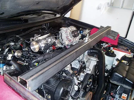

When I go to do my install, I am making something like this:

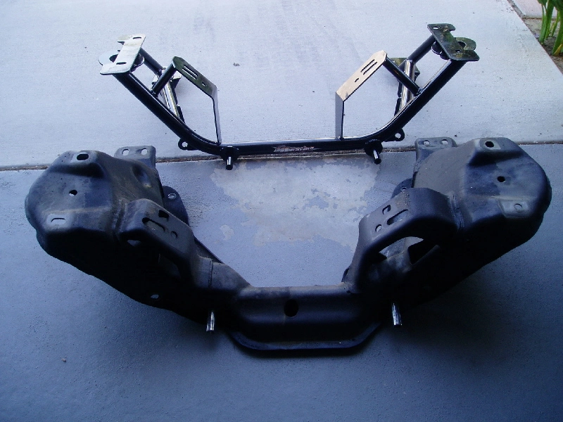

If you take the K-member out, for less than $400 you can put a lighter one back in. Its a lot easier to work with and saves a lot of weight. Here's a pic of a PA Racing K-member I put in when I did BBK headers.
ya i'm thinking about doing that this winter. U used stock A-arm right?
Yes

How much weight do you think you took off of the front end with the PA k member, and how is the ride quality.
