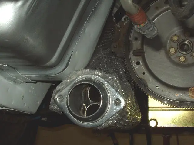

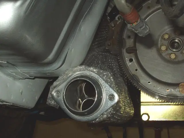

The BBK 351 Swap headers will NOT fit a AOD, but fir a C4 just fine. They are too close together at the primaries where they go into the collector.
You can see here, that the primaries and collectors line up with the bottom of my Canton pan. When the AOD is bolted up, it sits on the same plane as the bottom of the Canton. The primaries and collectors are just made too close to clear the AOD in the pan area.
I wish I had taken a picture showing them both, with a tape measure :)
