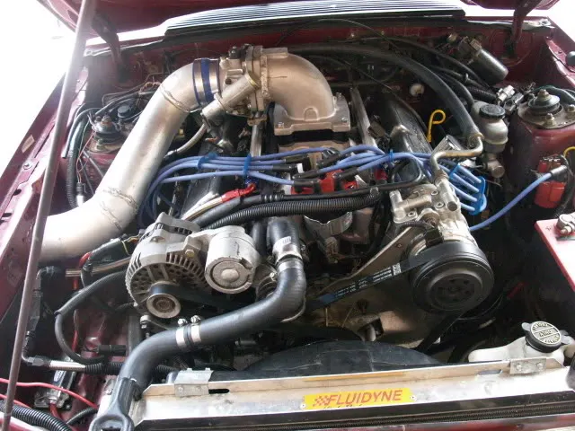

There is always Edlebrock Vic Jr EFI ........ aka Spyder
$350 intake, $80 fuelrails, $150 TB elbow ...... $580
Sure does look cool
