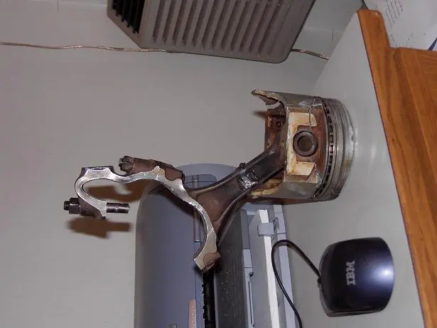

pulled the engine apart tonight or somewhat anyway, #5 outside rod bolt broke the cap off of it, looks like the break was old it was stained on about 3/4 of the break. well the cap sepearted and wrapped around to the other sidethe other bolt held, knocked around the block some didn't look like the engine turned much after it came apart, cracked the cylinder bore down the center, but for the life of me i didnt ruin the crank just scratched the bearing surface a little and hammered the counterweight some. i think the crank is still turnable. the piston slapped the head pretty hard though cracked it from the intake vavle relief to the center and bent it down. i looked hard at the head cant see anything wrong with it beside a knicked valve, i hope its not cracked the heads were in excellent condition for a clevland the exhause valves wern't burned down into the head, i set a straight edge across the valve stem tips and are all within a few thousanths. well the block is shot it might take a sleeve but i doubt it. im dammed determined to build one of these engines now. hope my dad has enough spare parts.
well i took a piston home so i could take a pic of it
