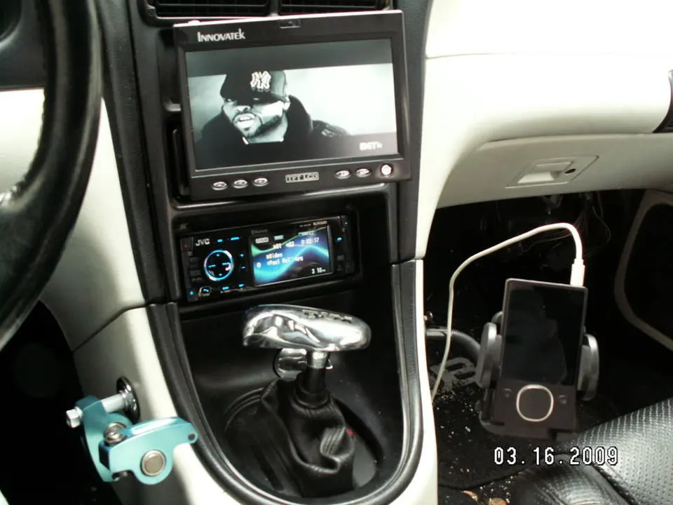

I dont use a key. I have a lever directly connected to the switch via a transmission cable. Pic below or the blue rocker Arms. Left side (Yes strange/ Odd i know) Its my way of getting money back for my pro comp Rocker arms. :D
Dude, what the crap are we looking at? I would say you are going to have to deal with this custom setup on your own. We can only tell you what Ford has presented us in past troubleshooting. Not your own setup....Tranny cable, and Rocker Arms belong where they were intended to be.
Its connected to the Factory sliding switch ignition switch. It functions the exact same way except not on the steering wheel column. The ignition wiring hasn't changed. If alot of the issues on these forums were only related to stuff "FORD PRESENTED US WITH" then 90% of us would be SOL. No troubleshooting issues with supercharges, nitrous, aftermarket suspension etc. Because you cant buy what i did in a jegs/ summit mag doesn't mean i should be denied help.
With that said as i have said before the turning action of the lever i created operated the SAME as it would on the column....just not on the column. Sliding ignition box is still there. Electrical for that box still functions the same....i just created the mechanical aspect of how that switch is triggered. So weather i slide that switch using a ket or a home made lever its the SAME.

No one should deny you help, but only you know what that monstrous picture is about. BET?? Good lord. You have the only Mustang in the world that is setup with 2 freaking rocker arms and a tranny cable rigged up. You explain that the ignition has something to do with the rig and also that the ignition switch has something to do with the quick fix. It easy to think that something was screwed up under the column when this was attempted. OK so now I know it was like this BEFORE your classy fix. I just have to ask WHY?? Just get a new key switch and be done with it.
