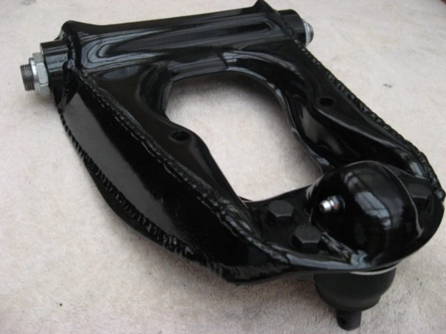

Beefed up my upper & lower control arms
I wasn't happy with how weak the replacement LCA's were so I beefed mine up a bit with some 10 ga metal. It's pretty simple if you have access to a welder and a vertical band saw, not to mention inexpensive. Just thought some of you diy'ers would like to check'em out. Up next is my upper control arms and strut rods.

Thats pretty cool. I bet that does strengthen them up quite a bit.

Those look great. The added strength is a bonus.

That's a not a bad Idea, maybe in the future. In the mean time I finished the UAC here's some pics.
I made a custom shaft for it and replaced the stock bushing with double sealed bearings. I think it came out pretty nice.

Nice job. I am glad to see more roller parts going in these cars. It is a fun project and really helps the car ride smoother and handle better.
I like the bracing under the arm, we put ours on the outside.

Thanks, I can honestly say I've got some of my ideas from your website. If I wasn't on such a tight budget I would've bought a set of your LCA's and track spring perches they are really nice.

What's the part number on the bearings you used for the uppers?

R10 is the trade number, they're for 5/8" shaft dia x 1 3/8" od. Mcmaster.com has high quality ones for around $8 bucks each.
